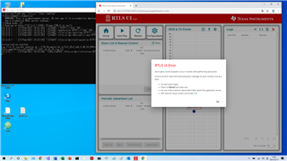

LAUNCHXL-CC26X2R1: RTLS UI ERROR
Part Number: LAUNCHXL-CC26X2R1
I will ask you a question for the first time.
When I execute "C: \ ti \ simplelink_cc13x2_26x2_sdk_4_40_04_04 \ tools \ ble5stack \ rtls_agent \ rtls_ui \ rtls_ui.exe" on Windows 10, "RTLS UI Error" occurs.
python uses Python 3.7.5.
The contents of the LOG file at this time are as attached.
Please tell me how to eliminate this error.
    Interesting; you are not the first to report this error. Can you check the suggestions in the thread below and see if you reach a similar conclusion as the other poster?
    LAUNCHXL-CC26X2R1: troubles launching RTLS Agent
    Hope this helps,
    Rafael
  • Thank you for answering.
    I saw LAUNCHXL-CC26X2R1: troubles launching RTLS Agent.
    The log data is only the one sent last time.
    Send configuration.json for reference.
    Please let me know if you have any further advice.

    Thanks for sending the .json configuration; it matches with what I have here.
    Regarding the log, given it seems very similar to what is reported in the other thread, I suspect there may be a scenario where something in the OS, the environment, character set/encoding may be influencing the ability of python to properly work. Searching the internet for similar errors indicate this is plausible.
    I will confer with some colleagues and see if I can reach some additional ideas.
    Rafael
    I was able to reproduce this issue in my personal laptop with Windows 8.1 (Brazilian Portuguese), therefore this is probably an error caused by the localization of the Operating System.
    I will report this to the development team and check for some possible workarounds or a scheduled fix.
    At this moment there is no known workaround other than change the localization of the OS.
    I apologize for the inconvenience,
    Rafael
    The dev team provided an updated <rtls_ui.exe> executable that I tested and worked on my Brazilian Portuguese Windows version.
    Please backup your existing rtls_ui.exe and copy the uncompressed file to the same directory.
    Hope this helps,
    Rafael
