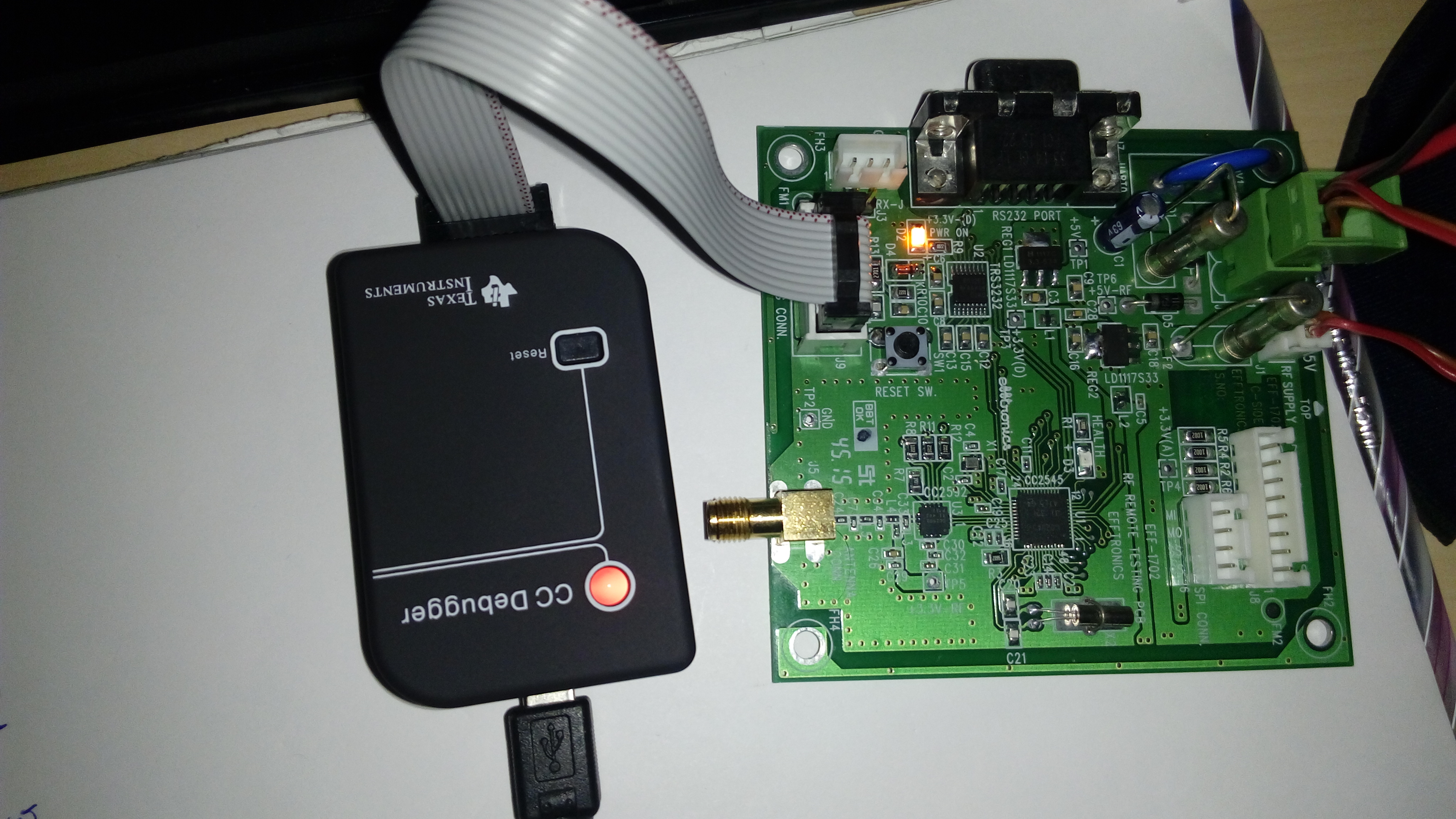

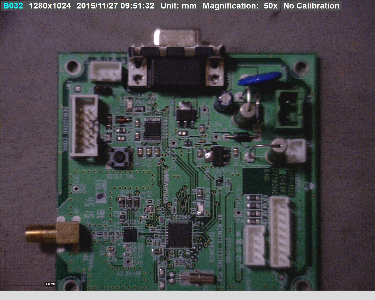

  • Hi sir,
    I was design a board with cc2545 chip .I was attaching the design file please verify that file let me know if there is a problem sir.
    EFF-1702 VER1.0.pdf
    I am connecting the cc debugger to the J9 connector which was in attached file.
    Manikanta.K
    Looking at your design, it looks like you have connected your desing's 3.3V source to J9-9, so you may have a drive conflict with the CC debugger, which also supplies voltage to that pin. You should disconnect the signal between J9-2 [3.3V(D)] and J9-9 [3.3V from CC debugger].
    Being that both should be 3.3V, I don't think it explains why you cannot detect the CC2545, but you should at least start with removing the drive conflict.
    TIABO
  • Hi Sir,
    I disconnect the J9-9 on my board and I confirm the voltage on j9-2 pin as 3V3.Then I was connected to the cc debugger .After this connection we pressed the reset
    Still the led was glowing in red color.
    is there any other bug in the circuit sir?
    regards,
    Manikanta.K
    In the attached schematics I don't how the cc2545 is connected to ground.
    I do see the cc2592 ground pad is connected to ground through logical pin #17, however,
    I don't see how the cc2545 ground pad is connected to a solid ground.
    When cc254x ground pad is not connected, or not properly soldered to ground, funny things will happen.

  • Manikanta,
    I connected my CC Debugger to a CC2545EM (mounted on a SOC-BB board). You can see the signal connection by selecting SOC-BB and CC2545EM from this online tool:www.ti.com/.../cross-connect
    From Cross-Connect you can also download the schematics for the 2545EM and SOC-BB board.

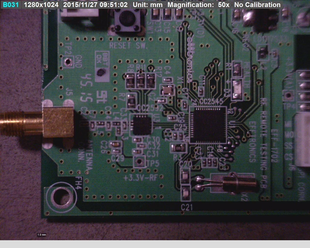

  • hi sir,
    I was checked the voltage across VDD,DCOUPL,RESET,RBIAS, are as follows:
    VDD:3.3V
    DCOUPL:1.86V
    RBIAS:1.254V
    RESET:3.3V
    CC2545 section as follows:
    Overall board:
    Could you please share the process how the clock will activate through software.
    Manikanta.K
  • Hi Manikanta,
    The boards look good. I really cannot point out any potential problems here. Are you absolutely sure the debug signals are connected correctly? Your debug cable is not too long? Have you looked at the debug signals, including reset, (close to the CC2545) with an oscilloscope?

  • hi sir,
    I am sure that debug signals are connected properly sir.
    After power on I was connected CC debugger as shown in the attached pic.
    We observe the Debug signals and Reset signal in oscilloscope.(All are 3.3V)
    we are not getting clock from crystal after power on the module. By this reason(clock from 32Mhz crystal) CC debugger may be  not detecting the chip.
    As you said SW will generate clock in the before post.
    How we can load the SW into the chip with out detection of CC debugger?
    IS there any other possible way to load the SW ?.
    Manikanta.K

  • hi sir,
    When am pressing the reset button on the cc debugger ,I could see voltage on the reset pin not completely falling to 0V level.
    But when I press the reset button on my board there is voltage transition from 3.3v to 0v. Connections are verified from my board to cc debugger . If there is issue that chip is not going into reset by pressing the cc debugger(because of no complete transition from 3.3v to 0v) then the chip should go into reset when I press the reset on my pcb.
  • I think I know what your problem is. Remove R10 (and possibly also C10 and D4) and I bet it will work.
    Let me know how it goes and I will explain more.
  • And don't forget to remove C35. :-)
  • No. C35 and R13 are part of the reference design and can be kept in.
    R13 is actually part of the problem, but the solution is not to remove that component. Can you explain why?
  • The reference design says 1nF, not 100nF -> way too much.
  • Hi Sir,
    I was removed the R13 and short with a wire .
    Now I connected the cc debugger it was detected the chip.
    Up to now we got a issue on RESET signal.
  • He has already confirmed that he uses 1 nF (100 nF was a typo). Otherwise you would be correct:)
  • Oh, missed that one, sorry.
  • I said that you should remove R10, not R13. The result will be the same, however R13 is used for filtering and should be kept in the design.
    The reason it does not work is because R10 is almost the same value as R13. Thus when the Debugger tries to reset the chip, it will only be able to pull the reset pin to VDD/2 which is not low enough to trigger a reset.
    The reset pin has an internal 20k pull-up so no external pull is required and R13 should be removed.

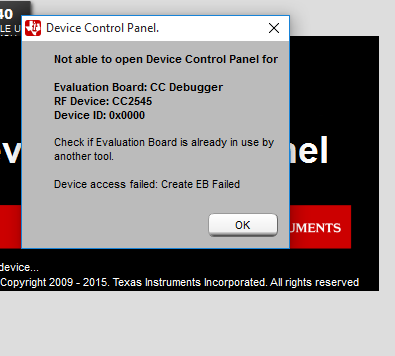

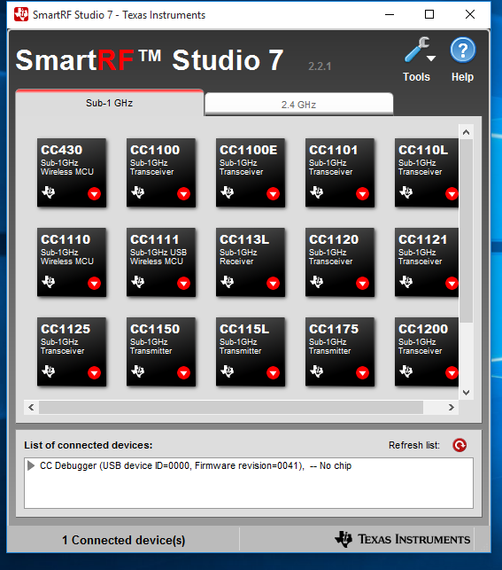

  • hi sir,
    I was connecting the two cc debuggers at the same time and to the same pc.
    having same usb device id (0000) to the both debugger.
    I am able to open the device control panel on one smart rf studio tool only .
    I am not able to open device control panel on another smart rf studio tool.
    the following window appears :
    Is there any procedure to change the usb device id for the cc debugger.
    or else how to connect the two boards to smart rf studio tool (one as tx and other as RX) at the same time to check the per test?
    Manikanta.K
  • Using 2 CC Debuggers with the same serial number will not work. You must change the device ID on one of them.
