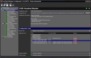

Hi TI experts,
My customer will design Gaming Headset project. they will use the CC8521.
at the purepath wireless configurator, devices name of Wireless USB Headset is CC8531.
Is this example also applicable to CC8521?
When applying CC8521, is there any change in the Purepath wireless configurator?
Thanks!

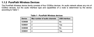

  • Downey,
    The difference between CC8521 and CC8531 is the number of channels supported. The CC852x devices support 2 audio channels, and the CC853x devices support 4 channels of audio. Otherwise, the devices are identical.
    The example in the screenshot above uses 3 audio channels, so if you want to use CC8521 you will need to reduce the number of audio channels. Once that change is the made that example should work on the CC8521.
