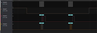

I have used a Logic Analyzer to view the SPI information and I have summarized my results in the following table
As you can see in the table, the TRF7970A receives information over SPI-MOSI (initialization and some read/write commands) but the data that sends back over SPI-MISO does not really look correct. I can confirm that the "random" values like 0x02 and 0x14 sent over SPI-MISO come from the TRF7970A, as I do not receive them when I remove the TRF7970A from the SPI-pins of my controller.

  • Hello JBF,
    Your SPI clock polarity and phase is incorrect. The TRF7970A only operates in SPI Mode 0 which is SPI Clock Low + Falling Edge data capture.
    Please resolve that first and then see how the system works. The incorrect values received are due to your SPI settings where the device is getting the wrong commands.

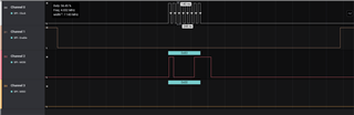

    I changed the SPI Mode to 0 (CPOL=0, CPHA=0). Unfortunately I still do not receive any information except when I try to read and write to register 0x00. In this case the data does not look correct either.
    Software initialization direct command:
    Trying to write 0x21 to register 0x00:

  • Hello JBF12,
    I must apologize! I've not supported this device for a while but our usual support engineer is on vacation so I am filling in. I was mistaken about SPI Mode 0, it should be SPI Mode 1 for Falling Edge Capture.
    To be explicit in terms of the SPI bus itself, the clock polarity should be the clock idles on logic '0' and the data changes on rising edge and latches on falling edge - looking at SPI modes, that is actually Mode 1.
    See below as an example SPI capture:
    Ralph Jacobi

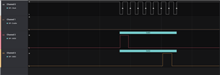

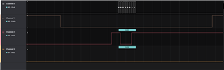

  • Hello JBF12,
    The initial setup steps are okay, but I see the next issue here - let's see if that's the last big one or not. While SPI is full duplex, the process of communicating with the TRF7970A is half-duplex in nature. This is because the register reads and such need to be sent entirely for the TRF7970A to know what to send back. So after sending the command to read a register, then the Master must trigger clock cycles for the TRF7970A to send the data back.
    Compare these two screenshots here to see what I mean:
    SS lowered, read command sent, no extra clock cycles, SS raised
    SS lowered, read IRQ register command sent, second set of clock cycles initiated, TRF7970A returns data on MISO, then SS raised.
    I believe that should get the data going well.

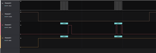

  • Hello Ralph,
    thanks for your observation about SPI being half-duplex!! It made me fully realize how to properly implement the reading process.
    I was somewhat expecting the slave to generate the clock for the MISO values, which is not how the SPI protocol works... Obviously this is the master´s responsibility.
    I can now read the values of the registers after the initialization, modify their value and perform continous read/write processes.
    For example, I write a certain value (0x35) to a certain register (0x02):
    To read the value of that register, the master sends the single address register read word AND creates another clock cycle while SS stays low. Only then, the slave can answer and send the data to the master over MISO.
    I noticed that in my case, the MOSI line stays high while the slave sends data to the master (which is fine, as the requirement is that there are no transitions). I guess that this is defined by the used SPI driver.
