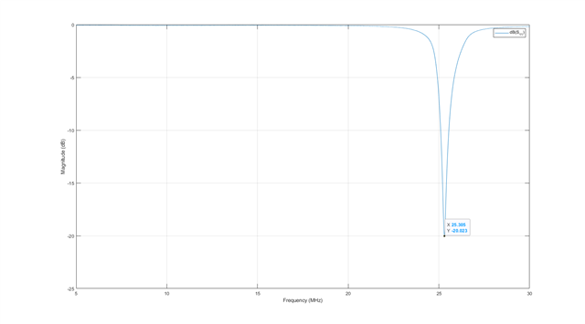

    This is same concern with developing a little wearable device with RF430FRL152H. We want to measure the quality factor of our NFC-circuit as in the SLOA217A - chapter 7.2 decribed. We did this measurement with an network analyzer and a self made single turn loop in Q11-mode. The single turn loop was directly connected to port 1 of the VNA and our device with the RF430FRL152H was coupled per NFC. This are the measurement results:
    Can we calculate the quality factor with this measurement methode? Or is there anything we should take account at? I ask because of this unknown impedance of the loop probe, which is not calibrated.
    Thank you for your support.
    Jonathan
  • Hello Jonathan,
    literature (for example ISBN: 978-0470695067) is describing also this VNA measurement method with coupling coil. So it is a valid method. The real part of the impedance curve should be plotted (rather than S11). The resonant frequency of the measurement coil should be significantly (>2 times) higher than the resonant frequency of the NFC circuit. Also some spacer (ca. 5...10cm) between the antennas would be advisable. If I understood correctly, a calibration measurement of the measurement coil is not required, as long as you plot the real part of the impedance. Alternatively a calibration measurement would allow to directly plot and calculate with the magnitude of the impedance.
    Andreas.

    Thank you for the good literature advice. Just for making it really clear to the costumer:
    In order to compensate the influence, they just have to make sure, that their coupling loop has no significant impact to the measurement in the interesting range (around 10-20 MHz). Than with the measurement of the real part of the coupling loop and the tag magnetally coupled to it, they will get the resonant frequency and quality factor of their tag.
    As it says "the measured transponder impedance is proportional to voltage u2 or current i2" (p.104), wouldn't their measurement in Q11-mode already be fine?
    Jonathan
  • Hello Jonathan,
    as said before, the coupling loop resonance frequency should be significant higher as the interested range, to avoid overlapping resonant curves. Some distance is required to not disturb the NFC antenna field.
    But I'm not sure if S11 can be used for Q calculation.
    Typically the Q factor is not that critical for new PCB antenna designs, because with the given PCB material and the typical dimensions the Q factor is usually in a reasonable range. Only copper wire antennas may have too high Q factor which, can be corrected with an additional resistor.
    Andreas.
  • Hi Andreas,
    Our customer wanted to thank you for this great support! This was really helpful for them. They got good results in measurements and they could determine the quality factor also with the S11 measurement.
