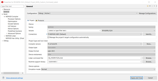

  • Hello Andreas,
    I already had the S6 switch to supply and the target-configuration enable, but when I looked for the target-configuration I saw that I had some parameters that were different from yours. Here is my project properties window:
    When I search in my linker command file I have only those 2 option for the rf430frl152h:
    Also, I know that I managed to upload a code on the board a long time ago but can't remember what my debug option was. Do you think that the current code can cause this error ? (I wouldn't think so, but just want to be sure)

  • Hello Alexandre,
    the "lnk_rf430frl152h_Driver.cmd" file is coming with the "RF430FRL152H SensorHub Project" example code.
    I don't think that the cmd file is the reason for your issues.
    Have you checked that the jumper SV7 between VDDB and VDDSW is present on the EVM?
    Andreas.
  • Hello Dries,
    Good catch ! It was in fact the SV7 jumper that was missing. I don't even recall removing it from the board, but now the code upload correctly on the board.
