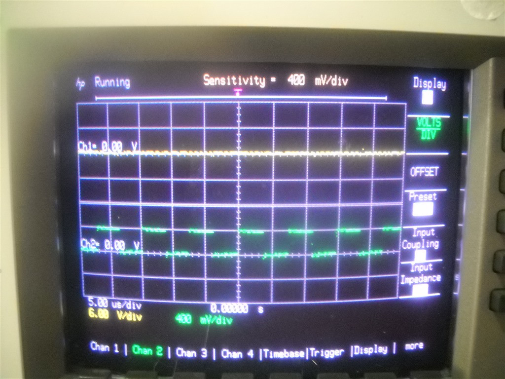

  • So I have a very nice Sync clock in Direct mode with the CC1101.  The data line though is not consistent.  It defiantly  detects when there is a transmission present (I can transmit a carrier and the data line goes high, which is what I expect.  I think the AGC needs some adjusting though, as I get a bunch of random "data" on the line that I suspect is just noise.
    My AGC Settings are
        SpiWriteReg(CC1101_AGCCTRL2, 0x03);
        SpiWriteReg(CC1101_AGCCTRL1, 0x00);
        SpiWriteReg(CC1101_AGCCTRL0, 0x91);
    Also another oddity is that the chip that the sensor is transmitting with I do not think has a preamble.  (AMIS-52100M) I tried to contact the manf, but that chip is out of production, and there is no engineer there that can answer my question. Like I said, I know part of the transmission, specifically the transmitter ID.  Any ideas on how to set up the cc1101 to put this into the FIFO rather then me trying to decode it on a scope in Serial Sync mode?

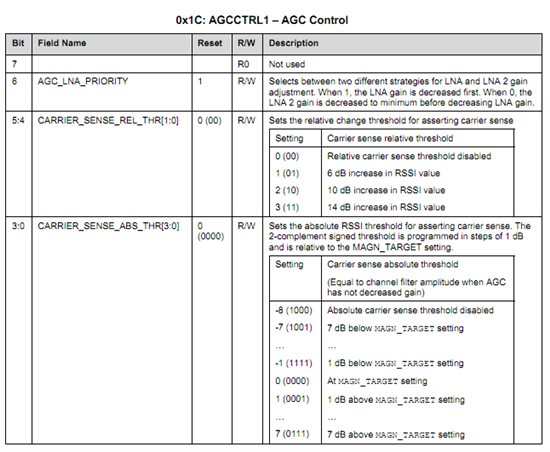

  • Also, which registers do I adjust for Carrier Sense levels?  The defualt settings gives me a constant carrier sense detected (always high).
  • Jerome,
    The register is called AGCCTRL1, here is a copy of what is in the datasheet. There are two modes the chip can operate in. You can select absolute level of RSSI or a relative level of RSSI, please see below.
    /TA
  • I have made good progress on this, but now I am having trouble getting consistent readings from the Direct Mode/Oscilloscope.
    Can you look at post: http://e2e.ti.com/support/low_power_rf/f/155/t/114736.aspx
