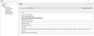

  • One way would be to
    1. Add the file pdm2pcm_cc26x2_ccs.asm file to your already imported project.
    2. Right click on it and click "Show Build Settings". Click on Apply Custom Build Step Overriding Other Tools.
    3. Add the filename and output object name.
    4. Add the compiler command with all the options. For example, as given below.
    "C:/ti/ccs1100/ccs/tools/compiler/ti-cgt-armllvm_1.3.0.LTS/bin/tiarmclang.exe" -c -mcpu=cortex-m4 -mfloat-abi=hard -mfpu=fpv4-sp-d16 -mlittle-endian -mthumb -march=armv7e-m -x ti-asm -o"pdm2pcm_cc26x2_ccs.o" "../pdm2pcm_cc26x2_ccs.asm"

  • Thanks. Using modified pdm2pcm_cc26x2_gnu.asm is a great solution for our project.
  • After commenting out sect, .func and .endfunc like this:
    /***CLANG*** .sect ".text.pdm2pcm16k" ***/
    The project buildt sucessfully, but the audio data was all garbage.
    Building the object file like you suggested using works builds fine, and audio data are good:
