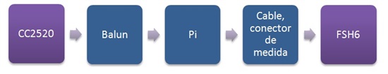

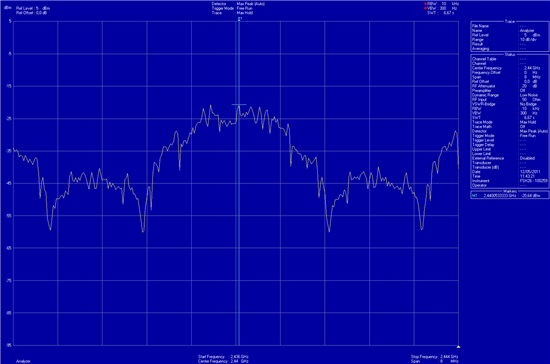

I have been measuring the output signal of CC2520 (chip+balun+pi) without the antenna connecting a coaxial cable and i have seen that depending of spectrum analyzer´s RBW i read different max output power.
The point is that when i reduce the RBW the maximum goes down the same amount of dBs as floor noise. Ok, i think that this is normal as we use DSSS. Anyway if i reduce the RBW i read very low output power for 5dBmCC2520 configuration: -20dBm.
RBW=10KHz            P=-20dBm
RBW=100KHz            P=-2.97dBm
Am i configuring the spectrum analyzer correctly?
Why i see so low signal?
If we configure the output power to 5dBm, is 5dBm expected max power or this power is extended over the channel?
Thanks a lot!

    The datasheet power is the total power from CC2520. When CC2520 is transmitting a modulated signal this energy is spread over the channel bandwidth.
    There are two methods to get a more correct power measurement.
    You can configure CC2520 to transmit an un-modulated signal. Use SmartRF studio to configure the chip to un-modulated transmission. If CC2520 is controlled by your own MCU, you use SmartRF studio to identify the right configuration registers settings for un-modulated transmission.
    Alternatively, you can widen spectrum analyzer RBW to match channel bandwidth 5MHz and read peak power.
    Whit sufficient S/N ratio these two methods should provide similar results.

    Perfect. I will try to measure the unmodulated signal. Anyway my Spectrum Analyzer ´s maximum RVW is 1Mhz so i can´t use the first method.
