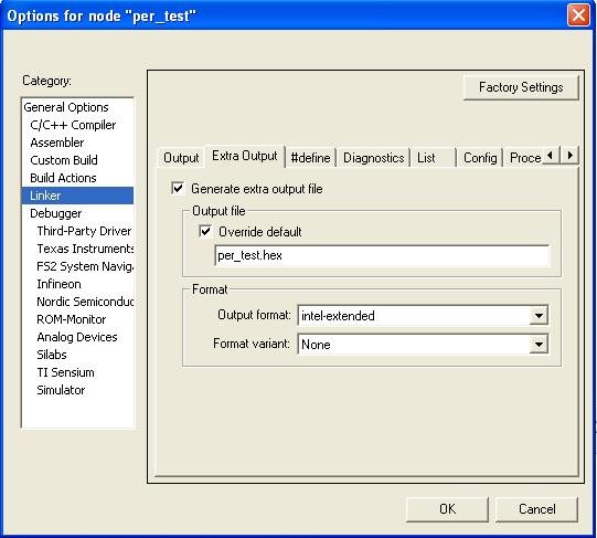

  • i have a question for you : what mean Extra Output of Linker ? And how it functions please ?
    Here, my output file is per_test.hex, how this file is builded please ?
    Thanks again !!!
  • To learn more about the linker, please refer to the "Linker and Library Tools Reference Guide" which is bundled with IAR Embedded Workbench (you'll find it in the Help menu).
    When you have enabled extra output, the linker will generate both the output file needed for debugging of the code in addition to a user selected output file format - in this case the Intel HEX file - which is a specific representation of the data that should be written to the flash of the device to run your program. So the extra output option is just a convenience to the user: Instead of building twice; first to generate the debug file, then the file used by e.g. an external flosh prog tool, you generate both files at the same time.
    Many tools, like our SmartRF Flash Programmer", can read the Intel HEX file to properly program the device.
