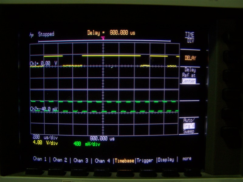

I am working on determining the format of an OOK transmitted sensor.  I have captured the transmission on an oscilloscope and now need to convert it to binary to determine the format of the packet.
I want to make sure I am doing this right.  I have captured 10 transmissions, and none of them are identical.  I don't expect them to be identical, but they should be close.
The picture below I read as : 11001111110110
My thinking is that for each cycle of the clock would be one bit.
I think this puts me pretty close.  The FCC documents state that the transmission is roughly 9ms and 76 bits long.  The 10 packets I have "decoded" are very close to that, 72-78 bits long.  They should all be the same length, but I am thinking that maybe the CC1101 might have some wakeup lag on the preamble part.  Here are the 10 decoded binary packets using the above method. (Non-inverted, so when data goes high, = binary 1)

So, Any ideas on why I am seeing this much variance in the Serial Output? Am I decoding it right?

    Since this is OOK signal and IF the transmitter is the dominant current consumer within the sensor you might be able to trace the transmitted data monitoring the sensor battery current/voltage. If data is detectable on battery, you can use one of the first edges as a trigger allowing you to log data from the same time instant in each package.
    If you are unable to trace the transmitted data on sensor battery current/voltage there is an alternative approach.
    CC1101 can generate a trigger signal based on received signal strength.
    First secure a high quality communication link (Short distance between CC1101 and sensor). Define a high Carrier Sense (CS) threshold and route the CS signal to a GDO pin (CC1101, datasheet ch. 14.4, p44). Using this GDO signal as oscilloscope trigger allow logging data from the same time instant in each received package.

  • I am using the CC1101 in Synchronous Serial operation (27.2 in the Datasheet).  which should give me direct access to the data.  Why would you suggest that I *NOT* use that mode?
    Anyway, there is no way to access the power source on the sensor.  It's encased in epoxy.

    When I did this it was for a GFSK signal and I used a third output from the CC1101 at the same time to provide an indication of RSSI above threshold. I used this signal to trigger the scope to and it also provided a good reference for the beginning and end of of the signal.
