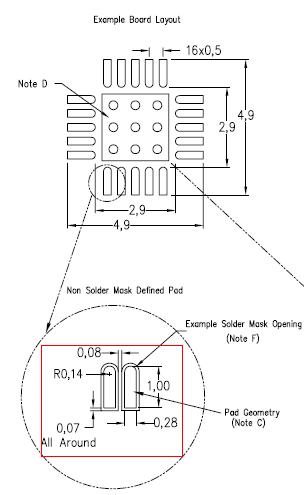

For one of our project we are using CC2500 for wireless connectivity. As per the datasheet of CC2500 the pad dimension has to be 1mm x 0.28mm as shown in the red box in the image below.

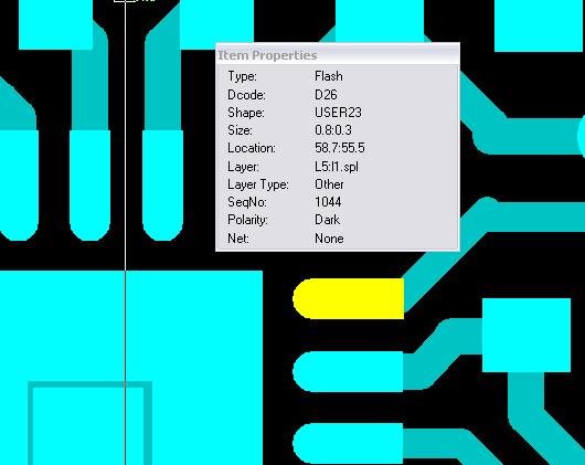

The referance design provided by you is 0.8mm x 0.3mm as shown in "Size" in the below image .please suggest which one should be followed
