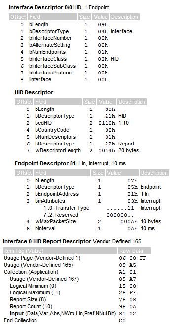

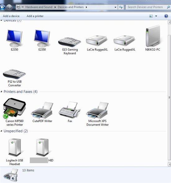

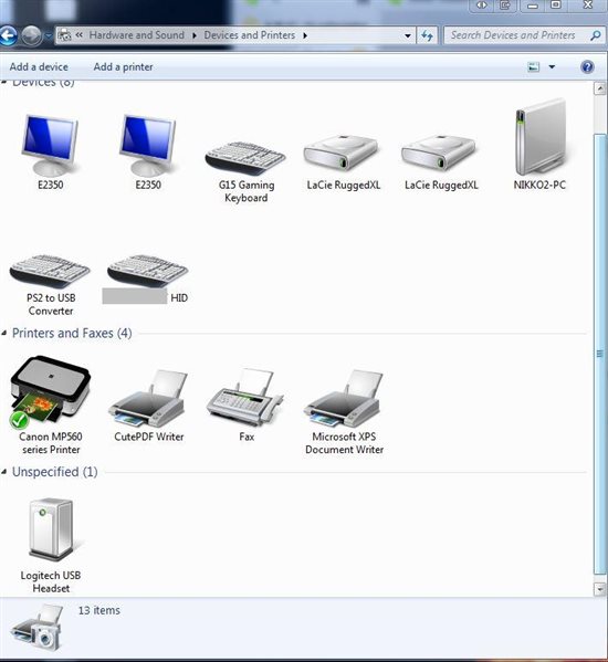

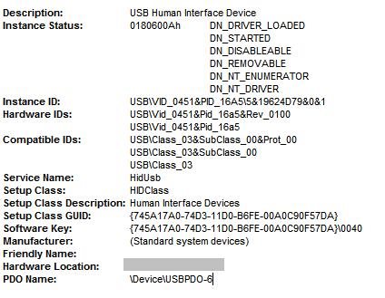

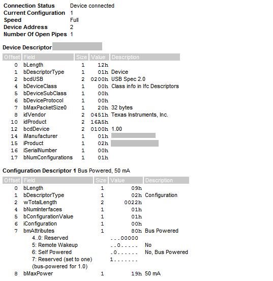

    I have modified the example "Simple Hid Dongle" located at swrc088c\ide\rfusb_cc2511\iar  in swrc088c.zip to my own custom HID to send 10 bytes of data.It works fine with some PCs but it gets detected as Keyboard device in some PC.I cant figure out what I must have missed.I'm attaching usblyzer and my descriptor below.Looking forward for your suggestions
entity0Desc:    ; Mouse report descriptor
                DB 06H,  000H, 00FFH  ; VENDOR DEFINED
                DB 09H,  0A5H     ; VENDOR DEFINED
                DB 0A1H,  01H     ; Collection: (Application)
                DB 09H,  0A7H     ;   VENDOR DEFINED
                DB 15H,  0H     ;  LOGICAL MINIMUM 0
                DB 25H,  00FFH ;   L0ICAL MAXIMUM 255
                DB 75H,  08H ; 8BITS
                DB 95H,  0AH ; 10 BYTES
                DB 81H,  02H ; INPUT DATA VARIABLE ABSOLUTE
                DB 00C0H            ;   End Collection
