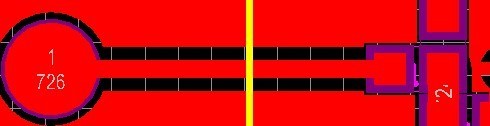

  • RRS,
    how can i decide the length of  trace of 50 ohm?It is between SMA and resistance in "CC2591 +CC2520" refernece.Below is the trace.
    And what are the values of these TLIN inductor in "CC2520+CC291"?I do not take these into account.Maybe these elements lead into problem.
    stones

             I find impedance of trace has nothing with length of trace.So I don't know how to decide the length of trace.And I want to know the value of TLIN inductor in "cc2520+cc2591".Can you tell me?

  • Stones,
    Once again we only give the load impedance which is found on page 7 of the data sheet.     Use the conjugate of this number to calculate your matching network.
    Rgds
  • Using the line calculator and enter the length width and permittivity found in the text file to get the impedance at  a particular board height.   You can use the same line calculator to calculate the values for a different board height.
    Rgds
  • RRS,
    Thanks for you reply very much.Maybe my english is poor.You did not catch me.I know how to calculate the impedance of line.But I do not know how to calculate the inductor of line that is emphasized in the picture.
    Rgds,
    stones
