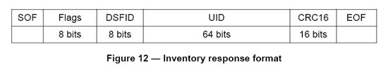

    When I send the collision command 0x8f 0x910x3d 0x00 0x30 0x04 0x01 0x00
    I get first an IRQ with flag 0x80. I react with a Reset Fifo Command (0x8f)
    After that I get an Interrupt with flag 0x60. Now I read 9Bytes from the Fifo.
    But the bytes seem to be shifted. The first two bytes are 0x00. In the third byte the ID begins. Why are the first two bytes 0x00 ?? why is it shifted?
    Thank you for your help
  • Christophe80 -
    This is not an error. The ISO15693-3 defined response of a tag to an Inventory Command is:
    So the two 0x00 bytes you are seeing that precede the UID are the error response flags (should always be 0x00) and the DSFID, which should be programmed as 0x00 from the factory (which you could change to another value if you want to)
    You do not see the SOF, CRC or EOF because the reader checks that (the CRC) for you and strips all three of them out of the response back to the MCU to reduce the handling required by the MCU of the response string.
