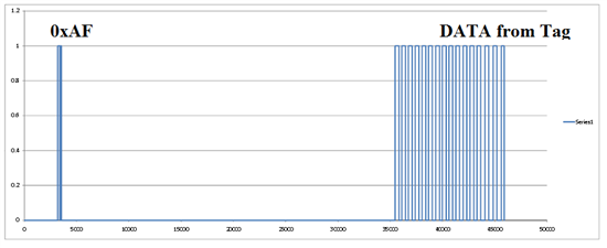

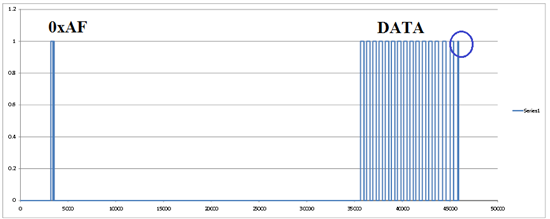

    i use RI-TRP-W9QL-30
    With 1 code:
             TXCT=1;
            delay_ms(200);
            TXCT=0;
            Start_caputre();//------------------> Capture input SCIO
            delay_us(50);
            TXCT=1;
            delay_us(2050);
            TXCT=0;
            delay_ms(51);
           TXCT=1;
            delay_us(3000);
    This is timing from SCIO ( with 1 tag, it have 2 Data). what is wrong? and what is data?
  • Lam -
    again, i think you will find better results if you change the timings as i indicated before.
