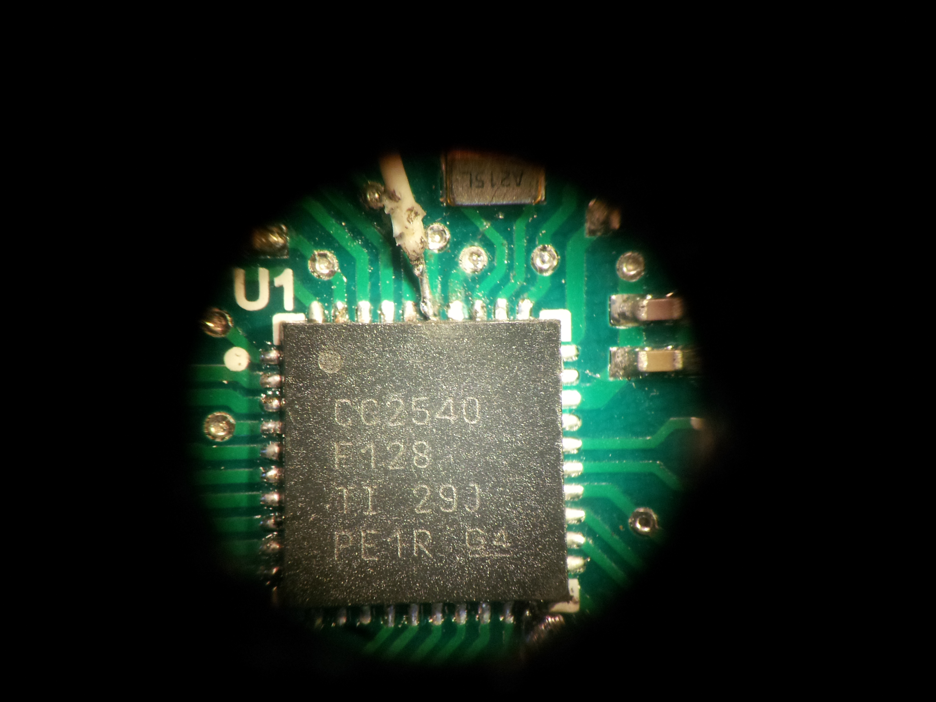

    I attach also a picture of the chip to see if you can identify where the chip comes from and if there is anything wrong.

  • Hi Fredrik,
    Yes we built 10 boards and we have the same problem in all of them. I guess the manufacturer didn't use good chips.
    We will try changing a few of them and see what happens.
    Cheers
    Matias.
  • Hi Fredrik,
    We finally changed the CC2540 Chips and everything is working fine now. So it seems that there are some chips around there which are not working.
    I already sent a picture with the complete chip code, maybe you can track them and find the problem. I have no idea where the manufacturer took those chips from.

  • Hi Matias,
    Great that you solved this issue. I will run the chip code through the tracking system and let you know if I find anything suspicious.

  • Hi Matias,
    I checked the chip trace code and based on this I cannot see anything unusual with the device.
