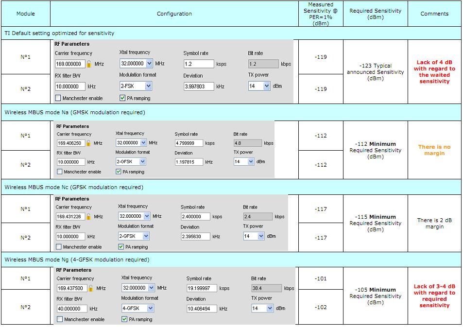

We are testing CC1120 EVK at 169MHz. We currently have the following performances in sensitivity :
- 1.2kbps 2-FSK : -119dBm
- 4.8kbps GMSK : -112dBm
- 2.4kbps 2-GFSK : -117dBm
- 38.4kbps 4-GFSK : -101dBm
Do you confirm this performances ? It seems that we have 3-4 dB less than announced in datasheet...

  • That is low.  What is the deviation, filter bandwidth, and are you correcting for crystal frequency errors?

    Below the configuration applied :
    For the crystal compensation, AFC is automatically turned on by Smart RF Studio.

  • For 1.2kbps, 4kHz deviation, 2FSK you should manage -123dBm.
    How do you do your measurements?
    The best method is to use a signal generator that sends packages
    If that is not possible, set a signal generator to send a '1010' pattern and set the CC1120 in synch serial mode.
    I have found that measurements with 2 CC1120EMs with an attenuator between gives inaccurate results becasue it is difficult to measure the exact attenuation.
  • We do the measurements using 2 EVK connected through variable attenuator, and then we use Smart RF Studio in expert mode with Packet Tx and Packet Rx functionalities.
    Xavier
  • Please also note that the RSSI value reported back from Studio is around 5dBm off for CC1120 in version 1.5.0. The RSSI offset is 101, not 96 as v1.5.0 uses. This will be corrected in v1.6.0 that will be released shortly.
    If you have a signal generator it is highly recommended to use this and if you don't have that possiblity double check what your attenuation really is. I found when I did similar tests that a variable attenuator has a insertion loss that has to be taken into consideration and you need to know the exact output power on the sender.
  • Also a power meter can be used to get the exact value of the power going into the chip.

    I think the main difference is due to error rate definition : it is not written in the datasheet that sensitivity is for 1% BER, and not PER.
    It can make a big difference in terms of measurement (at least 2-3dB).
    We will check in this way and keep you inform.
    Xavier
  • With 3byte payload 20% PER equals 1% BER.
    I noted that you wrote that AFC is activated in Studio. To use the calculated freq offset estimate you need to send a SAFC strobe. So for the narrowband test case please check that you sender and receiver is actually operating on the same frequency.
