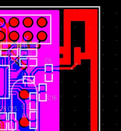

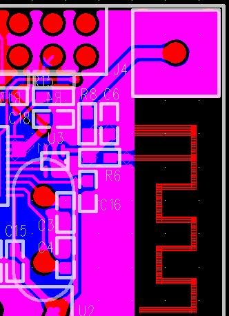

  • this is the layout. R6 and R8 is used to select MIFA or Whip antenna,  i think that's why the performance is not good. U3 is JTI balun 2450BM15A0002
    the following is the new design, use IFA and 2450BM15A0002. PCB is 2 layers 1.6mm FR4. Any suggestions about this layout? May i expect some improvement with this design? thanks
  • It is hard to tell from limited picture size all the issues of this layout but I'll mention the ones that can be seen in your snapshot.
    1)   Unless you validated the antenna input is 50 ohm then you should include a PI network as close to the Antenna input to handle impedance errors.
    2)  Impedance errors occur when the trace from the balun is not a 50 ohms,  antenna in not 50 ohms or the balun is not 50 ohms.
    3)  If you use 2-layer or more with ground fill on the top.  You need to connect all layer grounds by vias spaced at the wavelength of 1/10 of 2.45GHz.    Wavelength is given in meter/sec.
    4) Before connecting to the antenna you can using a coax measure the output power into 50 ohm termination of a spectrum analyzer to make sure the power you program is the what is being delivered to the antenna.
    5)  Then connect the antenna.  At this point you can take a TI reference board with a whip antenna,  add a whip antenna on the input of the spectrum analyzer and compare the referenece design power and your baord power at 1 to 3 meter separation.   This is an approximate reading since it includes multipath but gives a good indication everything is working close or same as the reference design.
