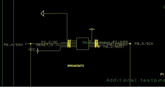

  • Hi David,
    Can you please post a schematics of the debugging part in your PCB.
    Thanks.
    Br,
    Igor
  • Hi Igor,
    hope you can see the picture. Pin numbers are not correct, but besides everything should be as in the reference design.
    Br,
    David
  • Hi David,
    The schematics seems alright.
    See what happens if you do the following experiment.
    1. Apply an external power (VCC) to your board
    2. Connect five wires to P10 on your board: A1, A2, A4, B6 and B7 pins
    3. Connect these wires to debugging connector A1->pin #1, A2->Pin#2
      and so on.
    Now, the led on the cc debugger turns green, or is it still red?

  • Hi Igor,
    it's been a long time but I promised you that I will come back on you and report my results. Finally we figuered out what the problem was. While doing the second pcb we discovered that our free stencil to apply the solder paste was faulty. Guess what, not all the pins of the soc very there. Unfortunately in the final pcb we could not see it since the pads had the same color. So many pins were not connected but when I measured I measured the pads (not very thin measuring needle). Now were able to flash and to program the chip. Anyways, many many thanks for your help and next time you are in south of germany send me an email and I'll pay you a beer or two *g*
