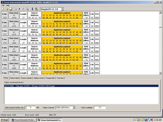

    I'm still working in this problem, now I'm using the packet sniffer to watch the simpliciti data, but I have a question, in the packet sniffer software we can chose the channel we want to receive, and I chose the 0x0b channel (2405MHz) which is the channel one in my application, but in some cases as you can see in the image below, I receive information of transmitter 1 and 2, not always happen but it occurs when I'm working with several transmitters and when the application lose data.
    We can watch in the payload 2 header bytes, 0x3131 is the ID 1 and 0x3232 is my ID 2.
    Could it be a bug in the packet sniffer or could it be that the CC2530 are changing the channel and making interference between them?

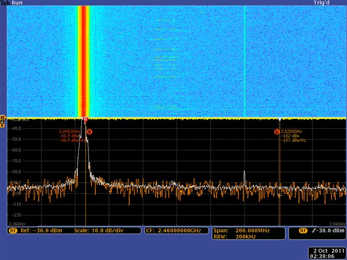

    I was making test on this problem, using an spectral histogram analysis I can see that when there is only one transmitter working the transmission is ok, as shows in the image below…
    The power on the transmission is constant over the time, this is the transmitter 1 and is located in the channel 11 of the CC2530 (2405MHz) at this moment there is not any data lose and the application works ok.

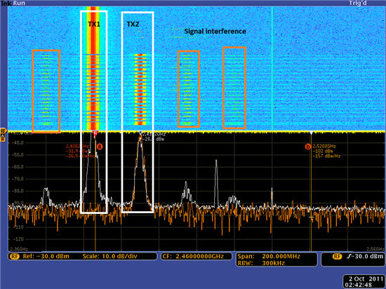

    Then I add a the second transmitter which is located on channel 16 (2425MHz), as you can see on the image below, the transmission seems to be paused, on time intervals, but the problem is that appear some spurious transmissions or signals interference in many channels which seems to be making noise in the other channels, marked in the orange rectangles on the image.
    I suppose that the CC2530 is doing this by some hardware function because the application is not using the frequency allocation function of SimpliciTI. At this moment still working well tha application, but if I add one more transmitter there are many data lost in the application.

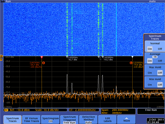

    Also I use the CC2500+MSP430 for this application, and as you can see on the image below there is no noise on the other channels, in the image below you can see the 4 transmitters working together at the same time with any lost information, but I need more power on the signals for my application, because of that I need to use the CC2530+CC2591 device.
  • Are the CC2591's all using the same power supply?  The additional energy at the other bands indicates there must be some modulation occurring between the two radios and the only way we can figure this would be happening would be if the power supplies are not sufficiently isolated.  Can you take a look at the spectrum on the power supplies when running both radios together and singly?  You may want to look at several of the decoupling caps.
    As for the blanking between transmissions, one theory is the RSSI measures in-band frequencies but the RF front end will amplify wide band energy as the receiver bandwidth limitation is applied after the IF stage.  Thus even if the RSSI is indicating low energy in the selected band, the AGC will want to increase the gain of the RF front end which could be saturating due to other channels if the received energy in those channels is large as might be happening on a lab bench with the radios closely spaced, especially if the CC2591's are enabled.  Can you lower the output power to a point where the received signals are in the -80dB range and see if you still get drop out issues?  Any chance you can run this experiment without the CC2591's?  I know this sounds like a channel separation issue, but keep in mind the separation capability of the part assumes the amplifier is not saturated for one reason or another.
