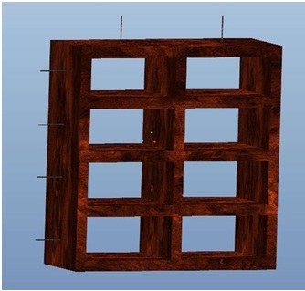

  • My desired range is nearly 10 cm for onne tag using one antenna and i prefer to use passive tag now because in library there are lots of books so active tag is not cost effective..
    i will be having a situation where i need to monitor a book stack kept in one compartment of shelf continuously through a antenna , the compartment length can be kept near to 10-15 cm and shelf will contain near to 5 compartment and below is the daigram  for this , the stick showing is antenna , this is one of proposed diagram.
    in my design , u can see there are many antenna needed for one shelf , will it will create disturbance in there working or for example are interfering the book will be detected by both antenna .
    I started working on trf7960 evm to get familiar with rf technology and now my next step is to start hardware setup of prototype using trf7960 from scratch , how i can start with it some basic help so i choose a right path , few tutorials or links which explain how i increase antenna range.
