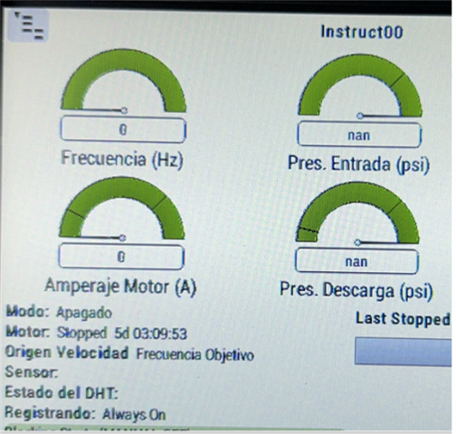

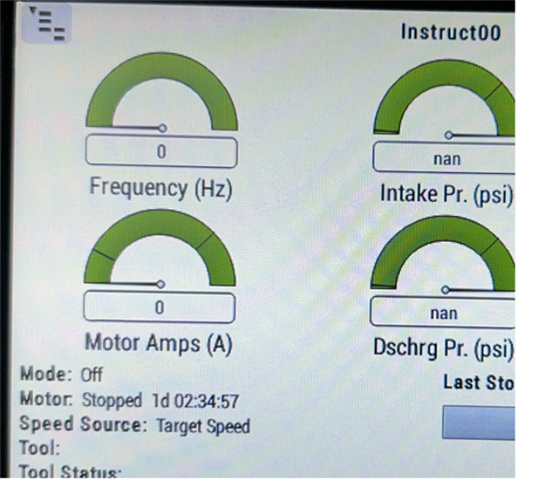

An issue was encountered during Instruct Controller FT testing.
Out of 78 units tested, 52 units were found to have a blur display. Further troubleshooting confirmed that this display issue is caused by component [MPN: SN74LVC8T245PWR]. Currently we are using parts from 2 different MFG (MFG A & Ti). Hence, the 52 units with blurry display are using Ti parts. Please see the comparison below.
MFG A:
Ti:
Is this condition acceptable? Do we have any acceptability spec/range for this?
