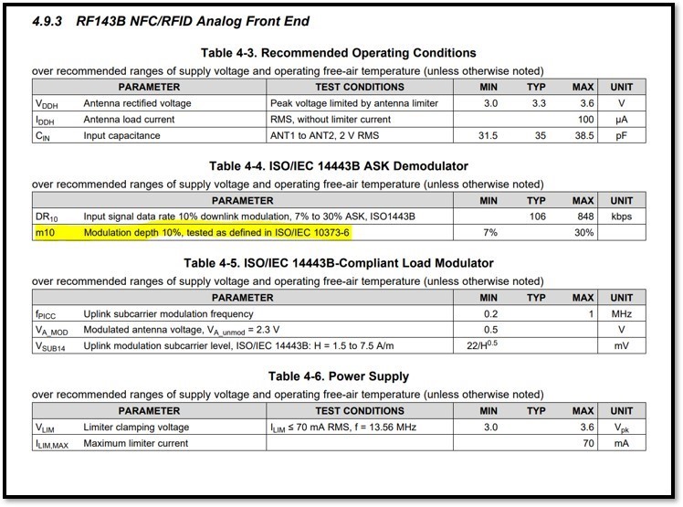

Could you help clarify the data sheet terminology? In section 4.9.3, it shows that the RF430 expects a 7-30% modulation depth for the analog inputs, shown in picture 2 below. Is this actual modulation depth, or modulation index?

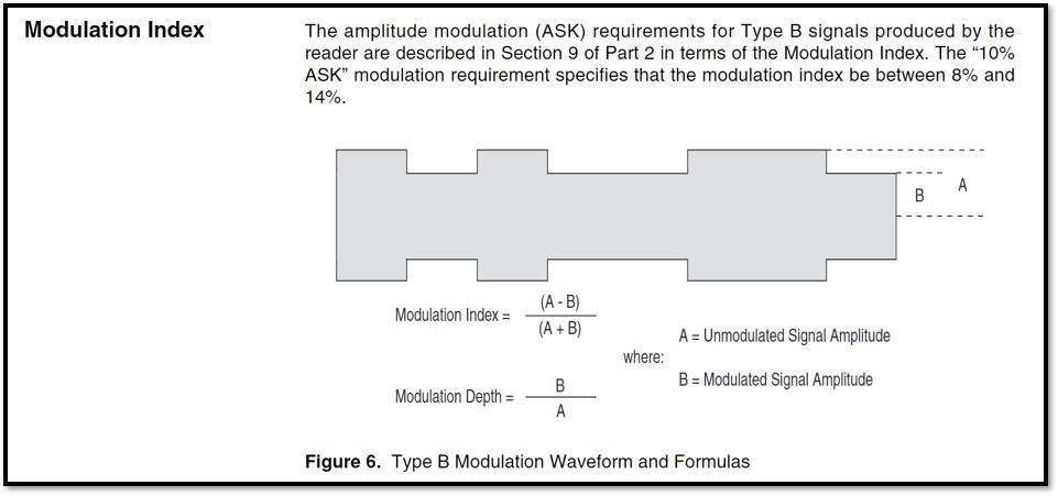

To my knowledge, modulation index and index is calculated according to the formulas in the first image below. Where I’m confused is that modulation depth is typically listed as a percentage of unmodulated voltage, but the data sheet seems to list it as the percentage decrease of the unmodified voltage. Can you help clarify if the data sheet is specifying in modulation depth, or is it actually in modulation index?

      I think modulation depth is used interchangeably with modulation index here. I believe on the datasheet, it refers to the formula (A - B) / (A + B) for test purpose.
  • Hi Charles,
    Could you point out where in the data sheet that formula is referenced? All other documentation I've read either explicitly defines the differences and relationship between mod index and mod depth, or only speaks on mod index.
    We’ve been evaluating PICC/PCD communication with the RF430. It seems like we begin to have some communication issues whenever we go higher than 93% modulation depth (~3.6% mod index). We can correct this issue by lowering modulation depth to ~91% (~4.5% modulation index). This is another reason why we were interested in specifically understanding this parameter on the data sheet.

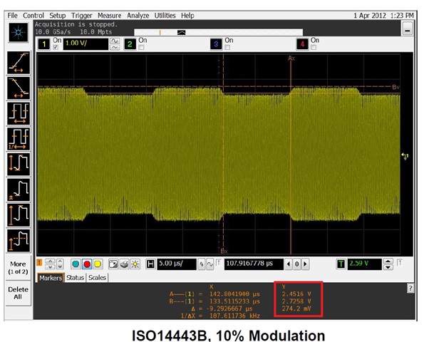

    In this TRF7970 Training material, there is a 10% ASK diagram. If you look at the delta on the voltage scale, it is 274.2mV and the unmodulated carrier is 2.7258V. Dividing 274.2mV by 2.7258V gives 10%. I would assume the RF430CL331H means the 10% modulation depth as in percentage.
    Here is the training material.
    8688.TRF79xxA_Training_05_2013.pdf
