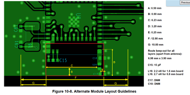

We use the layout guidelines mentioned in the device datasheet. some are reproduced here
For our layer stackup, the 50 ohm track width is 0.406 mm(16 mils), Whether the above dimension A through
G willm change accordingly, if so what is the values for A through G
thanks

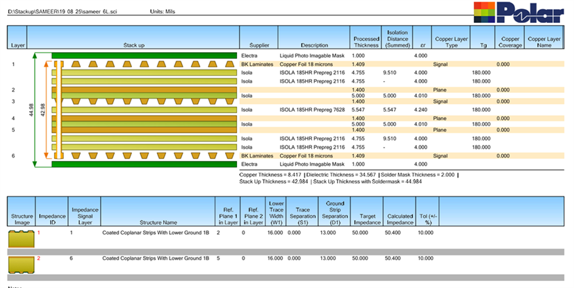

  • Please share your stack-up first. I do not want to assume and give you the wrong feedback.
    Bun
  • the layer stackup planned is given below.

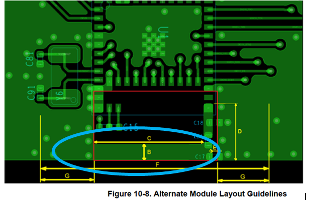

    1. In page no 60 of datasheet it is mentioned that "The ground loop should only be
          on the top layer of the board and not on all 4-layers", whether it means
        highlighed area in blue color in the following
          layout needs to be there in the layer where the device is mounted and to
         be removed in all layers, we have six layers, then whether it needs to be removed in all
         5 layers.
    2. Whether the pi network in antenna ground pin to ground loop needs to follow the track width of 16 mil as mentioned
        in the attached stackup

  • Regarding your initial question, we do not recommend changing the stack-up, but if it is unavoidable, then tuning the antenna match filter can readjust the frequency response.

    2. If you referring to Dimension A in figure 10-4, then it is 19.7mils. The idea is to match the dimensions of the ground pad at the top of the PI filter.

    In page no 60 of datasheet it is mentioned that "The ground loop should only be on the top layer of the board and not on all 4-layers", I understood that the  highlighed area in blue color in the following layout needs to be there in the layer where the device is mounted and to  be removed in all layers. But in the device design files from TI swrc382.zip, the ground loop connection for the antenna pin is there in all four layers.
    What I need to do whether to remove in all other layers or hold it.

    We try for 4 layers  if possible for our application, if so we follow the stackup & trackwidth recommended in the datasheet,  If we need 6 layer and use the stackup attached above, whether we can follow the recommended track width of 16 mils for 6 layer stackup, if so what other checks/changes we need to do for our PCB layout.

  • 2. In this case, the impedance of the trace does not have much impact as the length is short, but the discontinuity between pad and trace width will have a greater impact on antenna performance. We do not recommend changing the dimensions instead adjust the antenna match circuit.

    4. I believe you are saying that all 3 version has less power than the LP assuming this is radiated power the most likely cause is the stack-up and antenna dimensions because these parameters can completely shift the impendence of the chip itself and invalidate all filter circuits on the RF path.

  • Regarding Question #1 about the ground loop, it is the area you have shown, but only applies to the single-layer design (Figure 10-8) hence the comment. Antenna tuning is on the signal-layer is achieved through the matching circuit through. The 4-layer design in Figure 10-4 does not require a matching circuit but the dimension and stack-up must match the reference design.
    As for the track width, this is determined through EM simulations which gives you a better view of all the antenna parameters, such as efficiency, bandwidth, directivity, etc. Matching to 50 ohms is only part of the picture.
