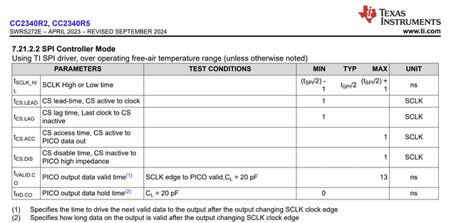

I use CC2340R53E0YBGR and ask about SPI communication operating in controller mode.
In the datasheet's Figure 7-1 "SPI Timing Diagram - Controller Mode, SPH = 0", there are notations for tSU,CI and tHD,CI, but their values are unclear.
Could you please provide these values?  I assume that these are data setup time and data hold time.
