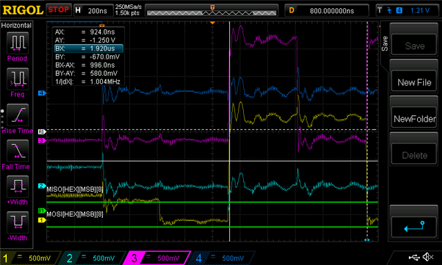

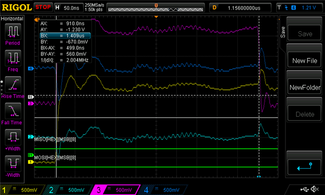

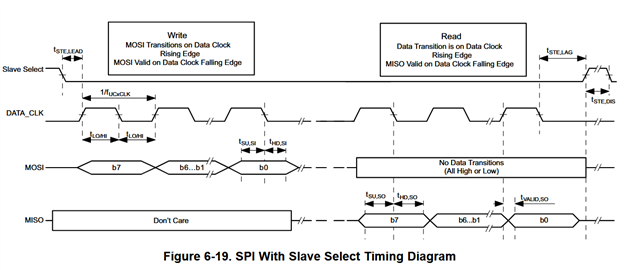

I've tried to verify the signals themselves against the timing diagram from the datasheet:
Looking at t_ste_lead, clock and duty cycle, lag time, and CS pulse duration between operations - they appear to be within the timing constraints - the connections to ground are rather long in the test setup, however. (CH4: CS, CH3:CLK, CH2: MOSI CH1: MISO)

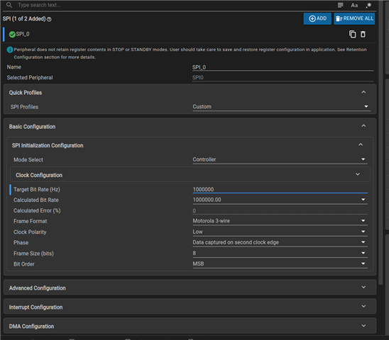

SPI setup (1MHz):
