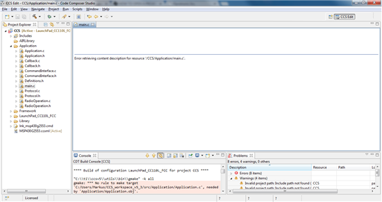

I'm running into some trouble with the CC110L AIR booster pack.
I've got both boards up and running, talking to the demo app GUI, but I can't for the life of me get them to pair up.
- I've got 2 instances of the GUI running, one connected to the hub board, the other to the sensor board, and they are graphing local temperature fine
- I'm using v1.4 launchpads with the crossover jumpers and the included MSP430G2553 chips
- The GUI is showing one unit set to hub and the other unit to sensor
- The radio settings on each are identical  (Radio 1 [FCC], Configuration 0, Channel 0, RF Power 3)
- The units are about 36 inches apart, plugged into the same PC
- I've followed the pairing procedures (press "discover nodes" on the hub, hold S2 for 2 seconds on the sensor) multiple times, but never see a second node in the node list
- I've tried changing channels and turning down RF power, still can't get it to pair.
What am I missing?   I don't see any reference one way or the other about the clock crystal for the launchpad, might that be the problem?
Bill
  • Have you tried with the newest software (and documentation) for the BoosterPack?
    1) Download and program the MSP430 with the latest version of the software for the BoosterPack (go to http://www.anaren.com/air-boosterpack/).
    2) Read the pairing sequence description in section 3.1.3 in the User Guide (http://www.anaren.com/content/File/BoosterPack_Users_Manual.pdf).
  • > 1) Download and program the MSP430 with the latest version of the software
    I'm using the latest version of the GUI but I didn't yet try rebuilding the firmware. I thought of that, but was trying to avoid adding another variable into the mix unless there was a specific reason to do so, especially since the boards are communicating fine with the GUI over USB.   Do you know of something specific that changed since the shipping firmware version (01.01:01.00:01.00)?
    Yes, I tried both the switch button method and the 2 GUI method, neither worked.    In the latter case, I see each board chatting away in its respective serial console, but neither one is picking up the other.
  • Sorry, I don't have the complete overview of the firmware changes, but I know that Anaren is working on adding that to their documentation. Anyway, I would suggest that you upgrade the firmware on the devices as well. The current recommended baseline is the version on the web.
  • Hi Bill,
    I would suggest you to flash the MSP430 with the factory default settings.This will help us to get on the same page and resolve the issue quickly.
    A new version of the Boosterpack Firmware should be available very soon on Anaren's Website.However, I am attaching herewith the latest Factory default hex file for the launchpad. This file can be programmed onto the launchpad using Flash programming tools such as the Elprotronics FET-PRO.
    You will need to select the microcontoller variant as the MSP430G2553 and then proceed with programming the launchpad.
    Please let us know if this helps to resolve the problem.
    -AIRTeam.

  • I am similarly having problems pairing the devices, so I'm trying to rebuild the code. However, when I download the code from Anaren and import it to CCS, it doesn't see anything. It basically can't open any of the .c files.
    How do I resolve this? (See screenshot)
  • I have the same problem with this. Tried to copy the firmware/src folder into my workspace folder, I could open the main, but the program has 18 errors with this Randomnumbergenerator file. I couldn't find a solution for this so far.
  • I had the same problem, but I replace those files by using "Import" those files (Firmware/src) and replace it.
