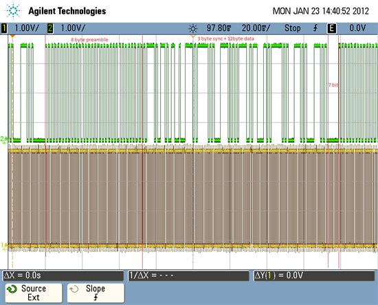

From generator we send the packet (25 dyte) :
0xAAAAAAAAAAAAAAAA - preamble (8 byte)
0xBE9D31 - our sync (3 byte)
0x1F5FD43EABE5C35FD43D41EA - coding data (12 byte)
0x0000 - 2 byte
CRC disabled - we calculate separately
Result: the received data (12 byte) - correct (0x1F5FD43EABE5C35FD43D41EA)

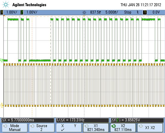

    When I TX 100 packets with max TX_power (very good signal + TX and RX device connected by a wire --> Perfect conditions). Whether should accept all packages always in such conditions? How value PQT_ERROR is calculated, if used 8 bit correlator, but PQT_ERROR can be more than 8 ?
    When PREAMBLE_CFG0=0x2F ---> PQT_REACHED always high.
    PREAMBLE_CFG0=0x2A ---> RX packets = 100.
    PREAMBLE_CFG0=0x28 ---> RX packets = 100.
    PREAMBLE_CFG0=0x27 ---> RX packets = 100.
    PREAMBLE_CFG0=0x26 ---> RX packets = 66, error packets = 31.
    PREAMBLE_CFG0=0x24 ---> RX packets = 11.
    PREAMBLE_CFG0=0x20 ---> RX packets = 3 - 0.
    On a task condition is required: detected preamble whis errors <= 2, if 3 errors ---> this is noise. Can i do this on CC1120?

    On Oscilloscope i see delay = 5.77 ms between each packets. This is RSSI Update Rate <= 5.77 ms ???
     On 1st picture i change preamble = 4 byte only. Data rate 1.2 kbps. With data rate =2.4  kbps -->  delay = 2.88 ms.
  • - The CC1120 uses a correlator to detect preamble hence the chip compares to waveforms. The PQT_ERROR is a measure on how equal these waveforms are and has basically nothing to do with the number of bit errors.With CC1120 the descition if you have received a valid package is normally taken with sync detect: If the radio detects a valid sync word it receives the rest of the data, if not it returns to sleep. It is important to fully understand your customers requirement.
    - It is not possible to know why you have the timing you have on package sending without knowing your full setup. In the RFEND_CFG0 register you can set which state you go to when you finish sending a package. if TXOFF_MODE is set to TX the radio can send packages back to back, if the radio is setup to return to IDLE after each package the timing will be different.
