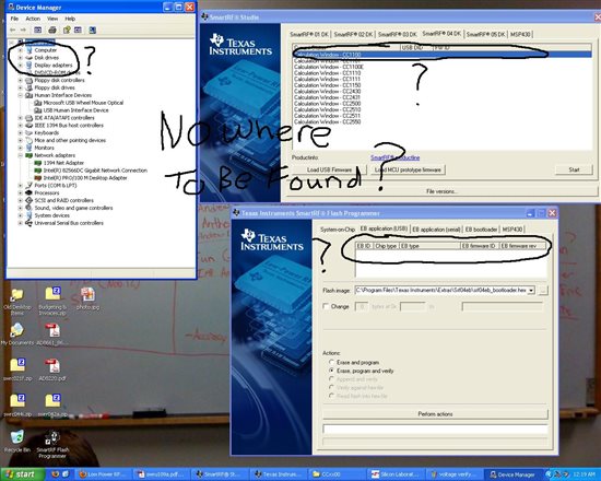

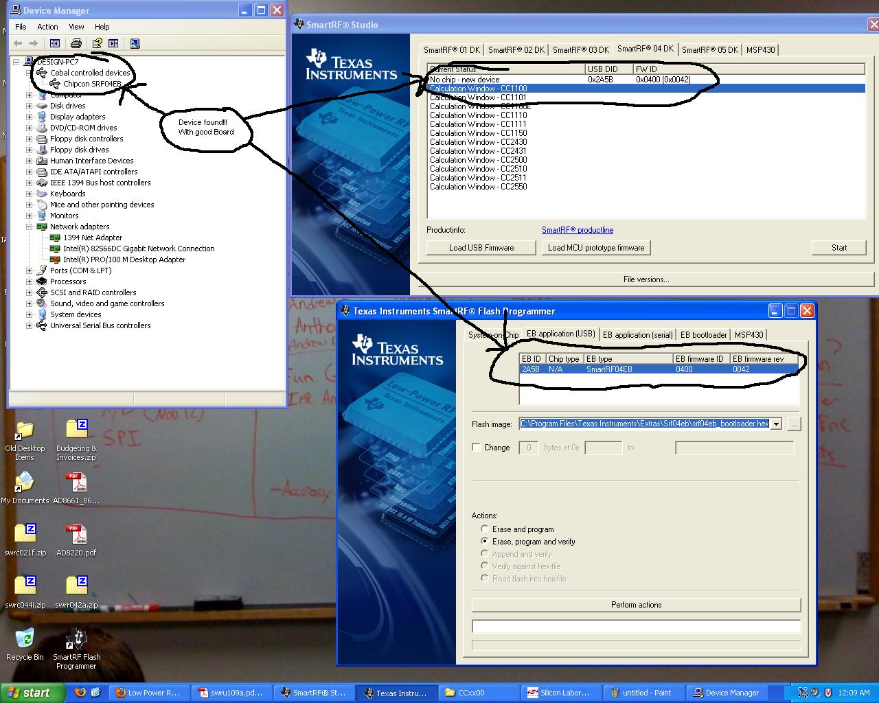

    Using the other dev board it is recognized right away and shows up in the device manager.

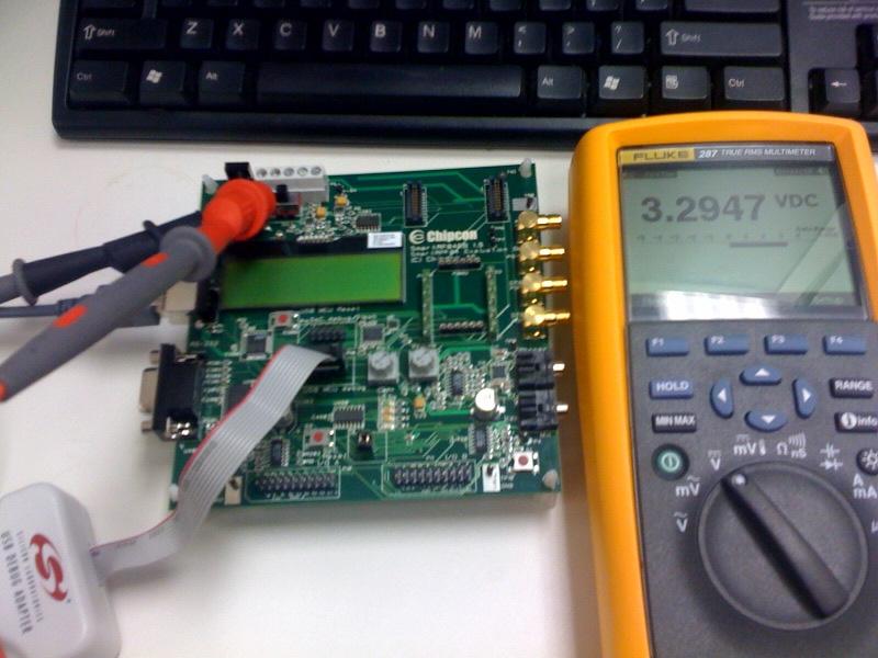

    i have verified that the voltage is correct from TP2 to ground.  I am going to include screen shots to further show the issue.
    here is the board showing up where it is supposed to working fine
    Non Functional board Power Verification
    from pin tp2 to tp3
    however.....
    nowhere to be found

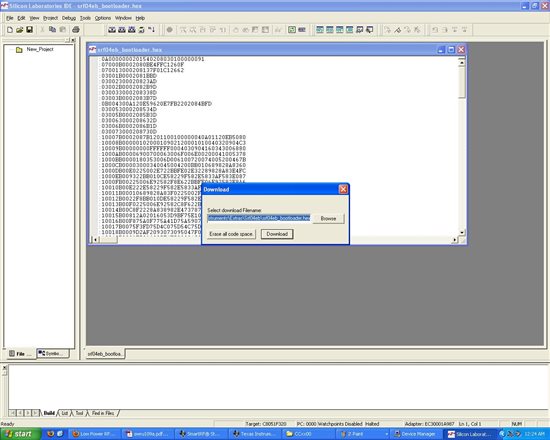

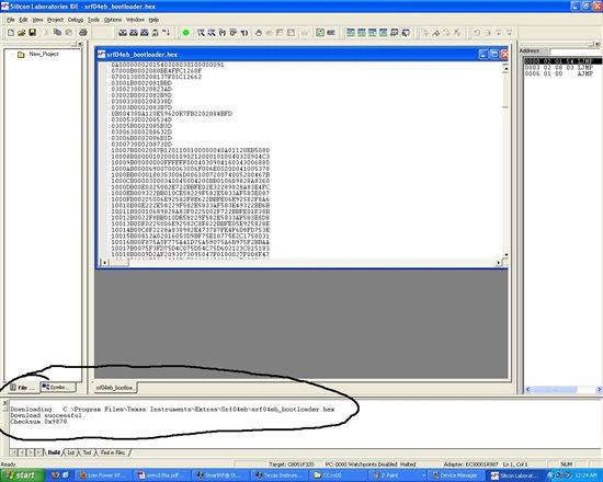

    Now I Will document my steps ive taken for attempting to fix the bootloader
    here is the device connected and the srf04eb_bootloader.hex file open.
    Here i am about to download the files
    And here it says it was successful
    Following these steps from my understanding should solve the problem however the devices screen is still blank and it is not recognized by the computer still.
    If i did something wrong please let me know. Or if anyone has any other ideas it would be much appreciated.

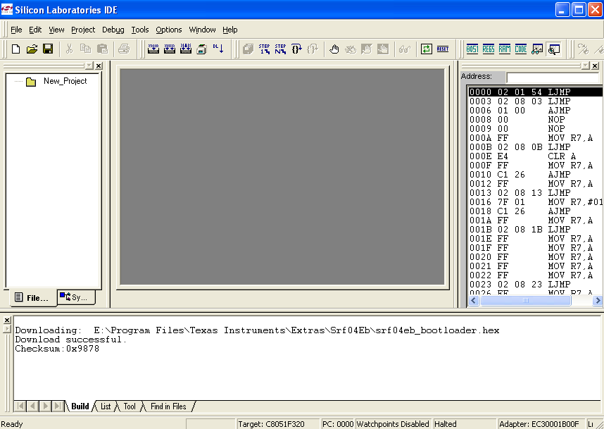

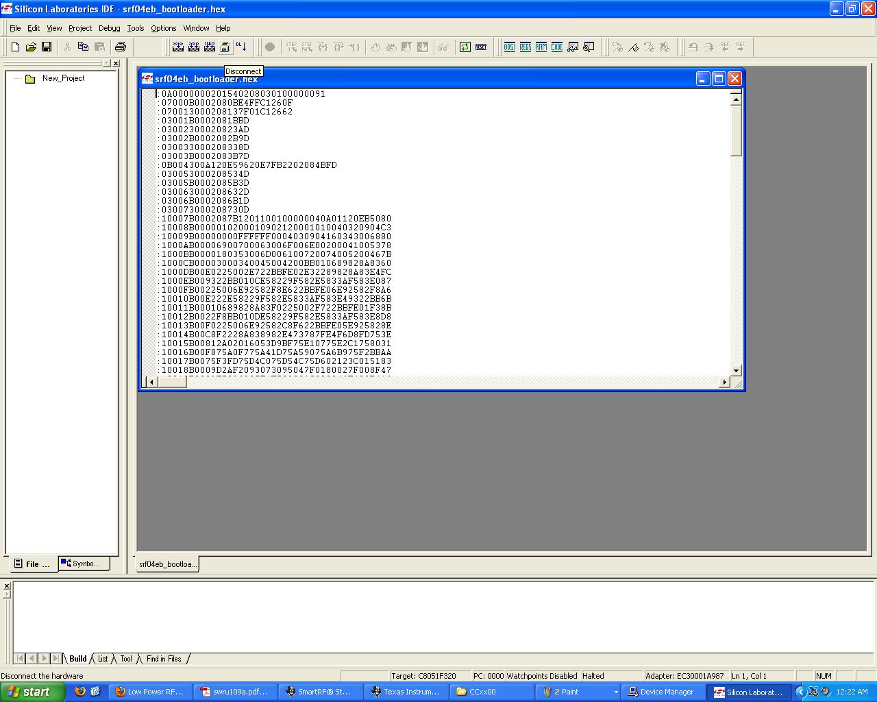

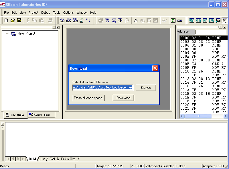

  • These image were taken this morning using a Smart RF04, SiLabs IDE, SiLabs Debug Module, and Ti's Flash programmer.
    You must use the SiLabs setup to load the bootloader and the Ti Flash Programmer or the new version of RF Studio to load the srf04eb_fwid0400.hex file.
    While you can load the srf04eb_fwid0400.hex using the SiLabs setup the SMRF04 board will not run.
    Start of process:
    Power down the SRF04 board
    Connecting the SiLabs USB debug adapter to the MCU Debug P301 on the Smart RF04 board.
    Opened the SiLabs IDE and removed any previous project
    Power up the SRF04 board
    Clicked the little monitor icon on the IDE to connect or go to options / connect
    Click the DL down arrow icon and the dialog box pops up asking for file name
    Navigated to \Program Files\Texas Instruments\Extras\Srf04Eb\srf04eb_bootloader.hex
    Clicked down load
     Text at the bottom of the IDE window states download successful
    Power down the SMRF04 BEFORE disconnecting the SiLabs debugger else it will die (I have 4 dead ones, we use the C8051Fxxx in many products)
    Disconnect the SiLabs debugger and connect the USB cable directly to the SRF04
    Power up the SRF04

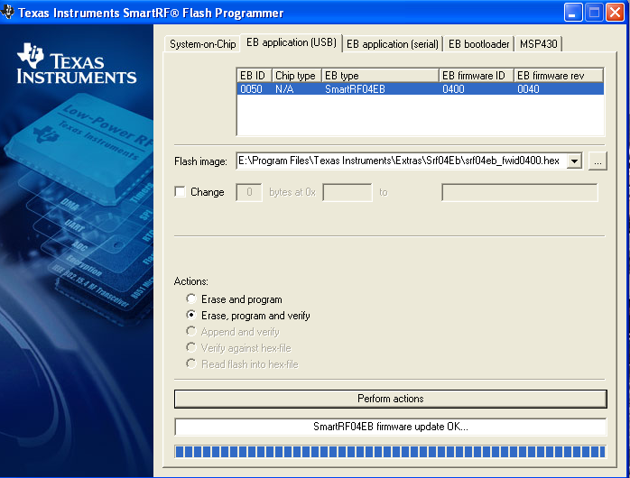

    The next two screens show the successful down load of the srf04eb_fwid0400.hex file using the Ti Flash programmer and to show it works I used flash programmer to down a application (light switch.hex) to a CC2430EM.
    Not shown is I opened Ti RF Studio and it also worked.

  • Step one is to measure the current to the board. Stick  DMM probes across the power switch with it open. Normal is about 35ma, a dead F320 will read 200-300ma. I have replaced several F320's for people on this forum if that is the problem.
  • Hello H. Stewart,
    I had measured the board current. If I use the 4-10V terminal, no current is consumed by the SmartRF04 board. However when I use the 3.3V terminal a little over 0.5A are consumed. I turn it off after 3/4seconds because the C8051F320 becomes really, but really hot.
    Humm, I can have a look into changing the chip...

  • I do not know if any of the latest Ti tools (Flash Programmer or RFF Studio) have been updated to accept the EC3 (USB) module.
    I have written a more detailed discription in the past on this forum but do not see it with a quick search.
    The RF04 is based on the SiLabs C8051F320.  If you download the free IDE from the SiLabs.com web site it will work.
    Open the bootloader found at C:\Program Files\Texas Instruments\SmartRF Studio 7\firmware\srf04eb_bootloader.hex in the SiLabs IDE once you have downloaded RF Studio from the Ti site.
    It is already a hex file so you do not build, compile, etc.
    Connect the module to the SRF04 and a PC USB port
    Power up the SRF04
    On the SilAbs IDE under options select connect and tick the box for C2. It should show information for the module.
    On the tool bar at the top of the IDE click DL and you should see the progress bar as the SRF04 is flashed with the boot loader.
    Close the IDE, open RF Studio and load the code.
    That is it....
