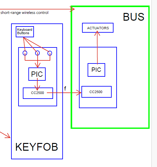

1.- Could you please specify the mandatory components that need to be purchased to implement the attached design using the CC2500 , PIC18F46K42 and ATECC608B?
2.- How many each?
    Although we can't comment about the PIC or the ATECC devices, my reply is limited to the CC2500.
    This transceiver can be configured and programmed using its SPI interface, allowing a host microcontroller to communicate to it. Our examples are tailored to the MSP430 family of devices, but the commands and syntax can be extended to the PIC.

  • How many Evaluation Boards will I need to Implement a full Transmitter - Receiver System? and What Tools will I need for the Implementation?, Thanks
    For a system that implements a two-way communication you need a pair of CC2500EMK development boards. These boards can be connected to a pair of base boards SMARTRFTRXEBK for an easier control via the SmartRF GUI.
    One aspect, however: the CC2500EMK is not in production anymore and therefore can't be found easily. The CC2500 part was released 20 years ago and therefore its support is limited.
    In this case, would you consider using a newer part such as the CC2340R2 or CC2340R5 for your design?

  • I was under the impression that only a single evaluation board would be required to implement both the transmitter and receiver system. Why cannot use only one evaluation board for programming the Transceiver?
  • Can the new replacement of the CC2500 be programmed with Smartrf Studio 7 as well?
    Do we need a different application for programming and setting up Registers?
    Sorry, I meant that you need a pair of CC2500EM boards - the CC2500EMK comes with a pair of boards, thus requiring only one kit to be purchased for both the Keyfob + Bus.
