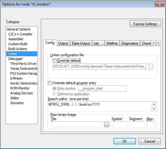

    You can find the linker configuration setting here: Project->Options->Linker->Config(tab)->Linker configuration file and click on the ‘…’ button to browse.
    Then navigate to the following location for the 8051 linker configuration file: $TOOLKIT_DIR$\config\devices\Texas Instruments\lnk51ew_cc2530F256_banked.xcl

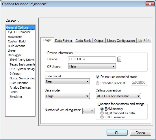

    When you open the rf_modem project in IAR, you will most probabaly get a message saying that the project is old and that IAR will try to update the project files. the problem is that this update won't do everything for you.
    Go to the Project Options --> General Options and set up the project as shown below.
    Note in particular the device. It should be CC1111F32. Click the "..." button to locate the device file in <IAR_install_dir>\8051\config\devices\Texas Instruments\. Set code model to Near, data model to Large and calling convention to XDATA stack reentrant.
    Next, go to the Linker options. REMOVE the tick in the override default check box. The default linker file will now be used.

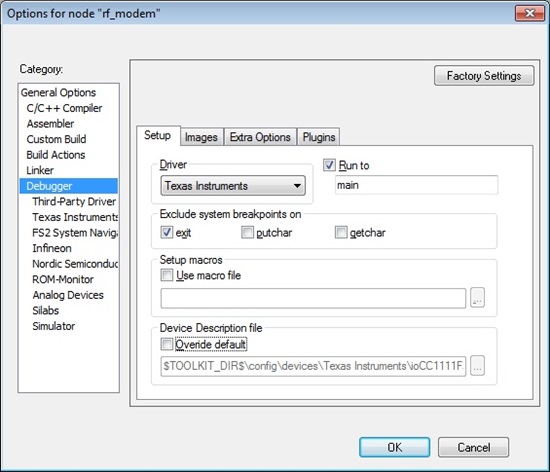

    Next go to the Debugger options. Again, REMOVE the tick in the Override default checkbox.
    Close the options dialog window and rebuild the project. The project should now be built without eny errors or warnings.
