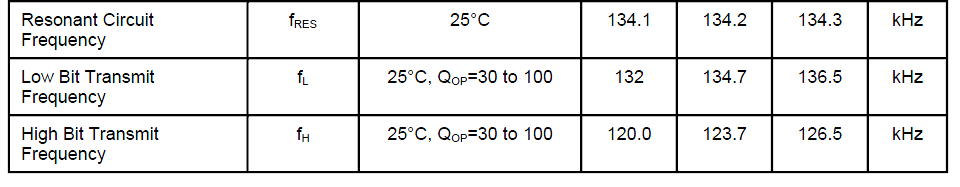

    Reader side (Downlink is 134.2kHz)
    the frequencies you are curious about are coming back from the tag, you know and they have tolerances.
    on the tag IC, we specify a couple of things around this
    1. Resonant Circuit Frequency ==> lets say @ 25C ==> min = 134.1kHz nom = 134.2kHz max = 134.3kHz (so you can see this is pretty tight)
    2. but then we have the Low Bit and High Bit  TX frequency tolerance specs. These are specified @ room temp, too (25C) with their Qop allowed to range between 30 and 100. So then the spec table might look like this - just for your information as to where the frequencies came from. THese are min, nominal and max value (just for example here)
  • Thanks Josh....you placed the subject of my query (134.7)  right in the centre of your frequency distribution matrix....I appreciate your attention to detail.
    The context of my persistence is this:-
    We tried to better identify why Canada were reporting larger number of "missed tags" than elsewhere.....
    We conducted a simple experiment with 100 tags to try and map the distribution of  "detectability"....
    Our set up was a 007 reader with a 1 metre diameter (27uH} coil and a ruler.... to record the distance away that a tag was "just detectable"
    Our suspicion was "off-tune-tags"... As in Canada they handle cattle in temperatures below -20 degrees...perhaps even...even colder!
    (as an aside...later we put heaters in the reader enclosures to keep the 007 etc modules "warm"...we saw your TI  prefered operating temperature range earlier)
    With the 100 sample tags...(which were recovered from an abbaitoir to reflect "well used" or experienced tags) we found a variation in detection distance of about  200mm
    We since colour coded thee tags from this group (red/blue/yellow) and now use these in our final testings elsewhere.
    We tried to correlate variance against tag manufacturer but this became inconclusive...we could not dwell forever on this matter
    We tried to "measure" the down-link frequencies but lacked the tools to do frequency analysis on the "pulsating FSK frequency" comming back from the tags
    We even set up a crude form of "grid dip oscillator" to find the tags natural resonant 134.2 kHz frequency....(low levels were used to avoid activating the tags)...the results were not conclusive but we "think" our simple experiment found higher and lower frequencies.
    Repeatability was not good, but was enough to set our minds at rest that variance in tag performance was most probably due to factors that influence resonance in a "free-running LC oscillator"
    So Josh, I guess I should have looked harder to find documentation about manufacturing tolerance....obviously tag manufacture is an "art-form"...a turn or two more or less for the person winding the tags coil, uniformity of wire gauge , mechanical tolerance of the winding bobbin....the list is endless...and we can do no more than accept it...and remember the role of chaos.
    thanks for your example table, it confirms two things for us...
    1. be more aware of tuning component tolerance...the issue of why the "high-Bit" is prone to different variance is probably due to that it is achieved by switching in "another" capacitor in parallel...a crude but effective technique
    2. be more aware of the role of temperature in modulating both the low and high down link frequencies, you have given voice to our conclusion to work around the extremes and we will now think in terms of 120 and 136.5 kHz as these.
