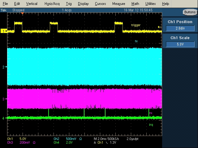

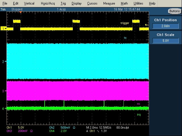

Reading block 00 from the tag. I noticed that if i leave the tag within the vicinity of the reader and let  the reader read over and over. I notice sometime the tag doesnt respond. See please attached screen grabs of a good trigger and bad trigger.
What conditions are needed to generate this trigger pulse?
Why does the tx of the reader only start 1.78mSec after falling edge of the trigger pulse? can this length be a varible to set the time shorter?
Same goes the for timing between the TAG EOF and the next trigger pulse edge (@1.2mS)
Does the Reader generate the IRQ signal that we measure on the pin or has it been conditioned by the MCU?
While in stand alone (viewing the LEDs blink) is it using the same setup (configurations) as working with the EVM control application?
GOOD
BAD
once in the 15693 tab we set protocol to read single block, double sub-carrier, high data rate.
We read blocknumber 00 and I can monitor on the scope a continious read of block 00 (as seen in capture images above).
