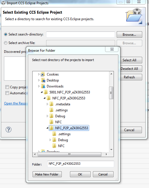

  • Hi Josh,
    I was just wondering what IDE those code examples should be tested in? For our project, my group is interested in the code for the MSP430G2553 and the TRF7970A, for P2.  I attempted downloading the zip file and then extracting the files to a different folder. Then using code composer studio, I switched my workspace to that folder.  After the workspace was switched, I received the following error:
    Description: Program "make" is not found in PATH
    Resource: NFC_P2P_eZ430G2553
    Type: C/C++ Problem
    I was wondering what would be causing this error or if I should be using a different IDE?
  • try selecting this path when importing to CCS on your machine...i just did same thing what you must have done and had 93 errors when i selected the top one, just one warning when selecting one shown below
