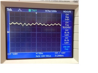

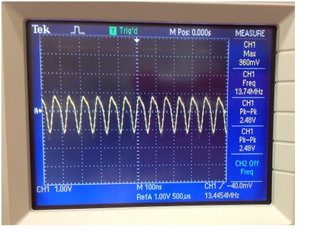

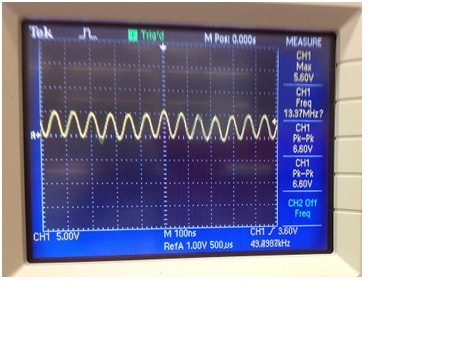

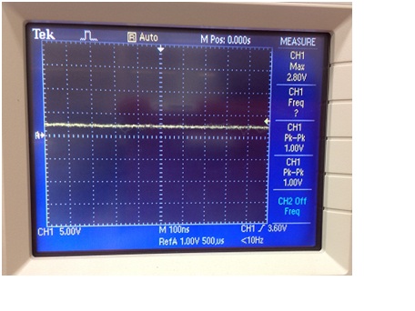

In this schematic, I replaced the LM1085 by the LM7812 and the two FETs IRF510 by IRF520. Is that OK? My problem is that according to your document, the output voltage should be 40Vp-p, but my output is only 2.48Vp-p. As a result, when I connect this circuit with the antenna, the read range is reduced. Here are some pictures captured at some test points suggested by TI’s document.
TP1 (6.6Vp-p)
TP2 (after crossing the inductor 169nH, it seems like the signal is filtered out, only noise remains. It’s very strange)
TP4 (PA drain, the voltage is always around 9.4V, it seems like the FET does not operate).
TP7 (output voltage, only 2.48Vp-p)

  • Hi I have meet the same problem that the Vp-p is approximately 2.5v when connect the reader with the amplifier.
    I just use the LM1085 and IRF510 (same as the document mentioned).
