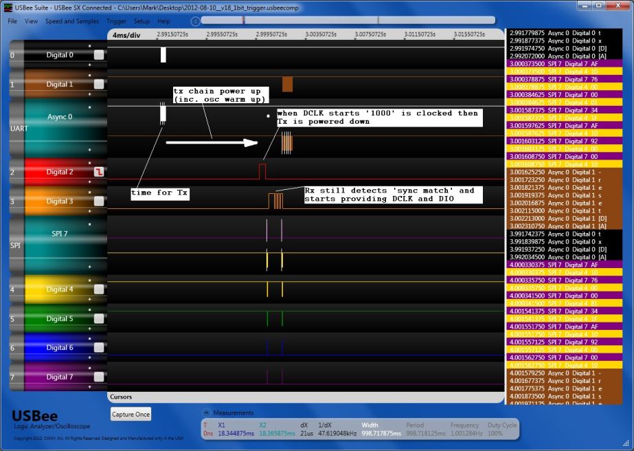

    The sync detect is not triggering on the preamble it triggers as soon as the carrier comes up.
    Maybe it is better put like this:
    CC1120 #1 is the Tx
    CC1120 #2 is the Rx
    If I put a scope on the data going into #1 while it is transmitting, and another probe on the data coming out of #2 while in RX I see ~ 750us propegation delay.
    The sync detect on #2 fires ~ 750us after the #1 starts transmitting. i.e. as soon as the first bit (not bits) of preamble hits the rx demod stage.
    I've attached a screen shot:
    This consistantly occurs at the same instant every time the Tx carrier comes up.
    The above signal was at -109 dBm and AGC_CS_THR was set to 0 (i.e. -100dBm), so I doubt it is carrier detect causing a problem (not sure how carrier sense could force a sync match though?)

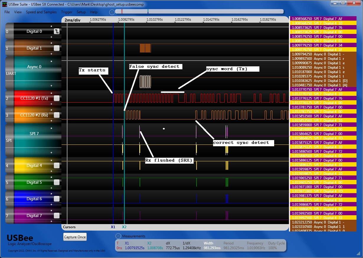

  • I'll also try just sending out 1 bit of carrier and see what happens.
  • I setup the same test. This time the Tx alternates between sending a message, then next time round just sending 1 bit (a '1') followed by 3 '0' then turns off the tx chain.
    Same false trigger occurs, so its definatly something to do with the CC1120 triggering on the carrier coming up.

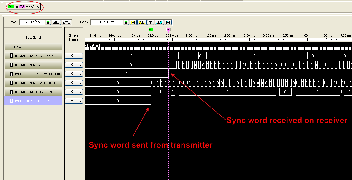

  • Hi Mark
    I have tested your settings on our HW and this works perfectly. The attached picture shows that the receiver does not start to output data or clock signal until the sync word is received. Since the CC1120 receives correctly from the CC1020, it sounds to me that the issue might be on the tx side. Can you do a similar plot as I did with the PKT_SYNC_RXTX signal (GPIOx_CFG = 0x06) output on one of the GPIO's for both TX and RX?
  • I think you might have hit it there.
    My guess is that this is happening:
    - MCU issues STX to CC1120.
    - CC1120 sends out sync word (automatically) then starts providing DCLK.
    - MCU on receiving DCLK, clocks out preamble then sync then payload.
    - Receiving CC1120 sees the first sync and starts providing DCLK.
    I'll check PKT_SYNC_RXTX and post back.
  • Mark
    When you use synchronous serial word on the CC1120 it automatically sends preamble and sync word before the serial data is sent (assuming SYNC_CFG0.SYNC_MODE is different from zero). This means that the MCU only has to provide the payload over the serial data line. If you sends additional preamble and sync word from the MCU the receiving CC1120 will already have found sync on the first sync word sent from the radio.
  • Hi Martin,
    I set SYNC_CFG0 to 0x00 before STX. Then back to 0x1C before SRX.
    i.e.
    - in Tx mode the CC1120 will provide DCLK as soon as the carrier is up. I then send the preamble, sync and payload using DCLK and DIO.
    - in Rx mode the CC1120 will not provide DCLK until one of two 16bit sync words is found. I then send an SRX when I have clocked in enough data and want to go back to sync word searching.
    All works fine now. Many thanks for your help on this.
