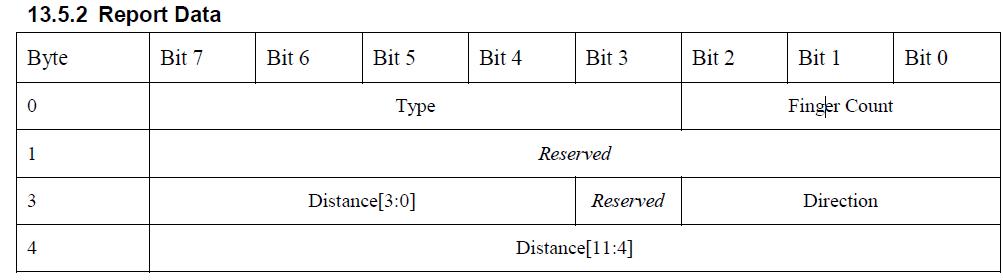

    I want to know how i apply for  scroll function in both side (Remote controller, target)
    for example,
    1. remote controller side:
        1) add to scroll variable in TX format.
        2) read data from touch-pad.
        3) send to the data a direction of target side through over-the-air.
        4) previous send to the data, what is the profile & command apply for read data from touch-pad? (In accordance with  RF4CE Spectification)
    2. target side :
         1) if i receive the data from recomte controller, What do i use the API for put the scroll data?
         2) using the API, then receive data is conversion to scroll function autonomically?
    If it is possible, please let me know what can  i use API List. and how can i apply API.
    Thanks you.
    Best reards,
    IK.JANG

    According to yout advise, Can I create to the function As like below?
    Based on Static void rsaBuildAndSendZidMouseReport( uint8 mouseStates, int8 mickeysX, int8 mickeysY ) Function,  Can i create new function is create as blow?
    static void rsaBuildAndSendZidMouseReport( uint8 mouseStates, int8 mickeysX, int8 mickeysY )       -> static void rsaBuildAndSendZidScrollReport( ( uint8 type_count, int8 dist_dir, int8 distance )
     uint8 buf[ZID_MOUSE_DATA_LEN + sizeof(zid_report_data_cmd_t) + sizeof(zid_report_record_t)];    ->  uint8 buf[ZID_GESTURE_SCROLL_DATA_LEN+ sizeof(zid_report_data_cmd_t) + sizeof(zid_report_record_t)];
      zid_report_data_cmd_t *pReport = (zid_report_data_cmd_t *)buf;
      zid_report_record_t *pRecord = (zid_report_record_t *)&pReport->reportRecordList[0];
      zid_mouse_data_t *pMouse = (zid_mouse_data_t *)(&pRecord->data[0]);                                                ->  zid_gestureScroll_data_t *pScroll = (zid_gestureScroll_data_t *)(&pRecord->data[0]);
     uint8 txOptions = (mouseStates==0) ? ZID_TX_OPTIONS_INTERRUPT_PIPE : ZID_TX_OPTIONS_CONTROL_PIPE;               -> ????????????
      /* Rapid mouse movements should go OTA via Interrupt transmission model, no broadcast */
      pReport->cmd = ZID_CMD_REPORT_DATA;
      pRecord->len = sizeof(zid_report_record_t) + ZID_MOUSE_DATA_LEN - 1;               ->   pRecord->len = sizeof(zid_report_record_t) + ZID_GESTURE_SCROLL_DATA_LEN - 1;
      pRecord->type = ZID_REPORT_TYPE_IN;
      pRecord->id = ZID_STD_REPORT_MOUSE;                                                                      ->   pRecord->id = ZID_STD_REPORT_GESTURE_SCROLL;
      pMouse->btns = mouseStates;                                                                                              ->   pScroll ->type_count=type_count;
      pMouse->x = mickeysX;                                                                                                            ->   pScroll ->reserved= 0
      pMouse->y = mickeysY;                                                                                                            ->   pScroll ->dist_dir= dist_dir;
      /* Send report */                                                                                                                           ->  pScroll ->distance= distance;
      rsaState = RSA_STATE_NDATA;
      RTI_SendDataReq( rsaDestIndex, RTI_PROFILE_ZID, RTI_VENDOR_TEXAS_INSTRUMENTS, txOptions, sizeof( buf ), buf );
    Please check the contents of the above and let me know about the part you want to modify.

  • Hi Jang,
    It looks good. I would recommend using short for distance, since distance is a 12 bit field.
    This structure may be better suited:
    typedef struct {
      uint8 type_count;         // Bits 0-2: Finger count; Bits 3-7: Type of gesture detected
      uint8 reserved;           // Reserved
      uint8 dir:3;              // Bits 0-2:
      uint8 reserved:1;           // Reserved
      uint16 distance:12;       // Bits 3-15: Distance[0:11]
    You can set tx options to ZID_TX_OPTIONS_CONTROL_PIPE or ZID_TX_OPTIONS_INTERRUPT_PIPE depending on the latency you require and the frequency of the reports. Interrupt pipe is less reliable, but faster, hence suitable for pointing data.
