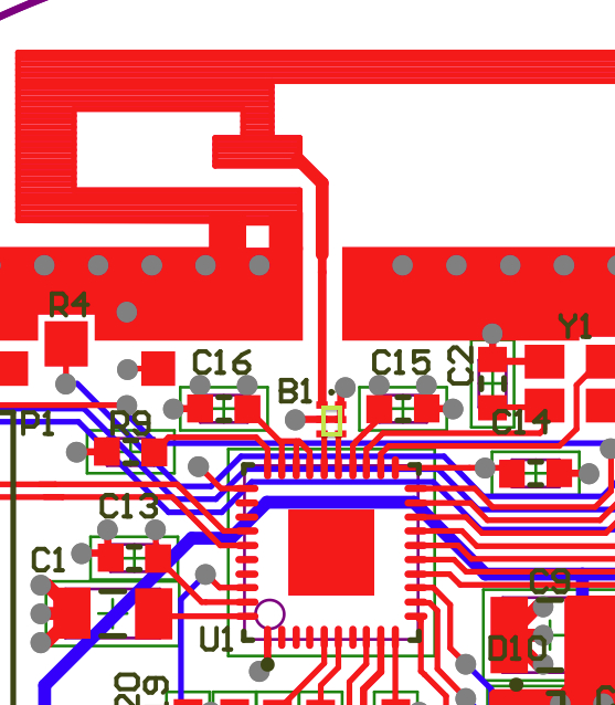

I've designed my first pcb with an inverted f antenna solution and I'm having problems getting it to communicate to the iphone test app designed by TI.  I have a keyfob pcb that connects fine.  Both the keyfob and this design are programmed with the same code.  I was hoping you guys could take a look and see if something obvious is wrong.
I'm not an RF or antenna expert. I've followed the design notes and I'm using a Murata Balun documented here.  I've attached a screenshot of the pcb layout. The area in the green box is where the balun sits.  Pins 2, 5 and 6 are connected to ground.  Pins 3 and 4 are connected to pins 26N and 25P of the CC2540 respectively. Pin 1 is connected to the antenna design.  The balun is as close to the chip and antenna as possible. There is a power plane and ground plane in the middle layers that is not shown in the image below. The planes do not extend under the antenna.
I don't have a way to measure the antenna impedance. Although I would have assumed that a weak signal would have at least connected to an iPhone when the device is within inches.
Any help in debugging this would be great, thanks!
  • Jonathan,
    There are a few comments to be made out here with regards to the overall layout of the board. You should read the following article. It gives some good info about do's and don'ts while laying out the RF boards. (http://www.ti.com/litv/pdf/swra367a)
    Having said that, is there a way for you to verify if both the crystal oscillators on your board are functioning?
    Also, can you connect your device to SmartRF Studio and perform basic RF communications with the keyfob? You could follow the basic RF testing document to perform basic RF tests (http://www.ti.com/litv/pdf/swra370)
    You might need two CC Debuggers. One for your board and the other for the keyfob.

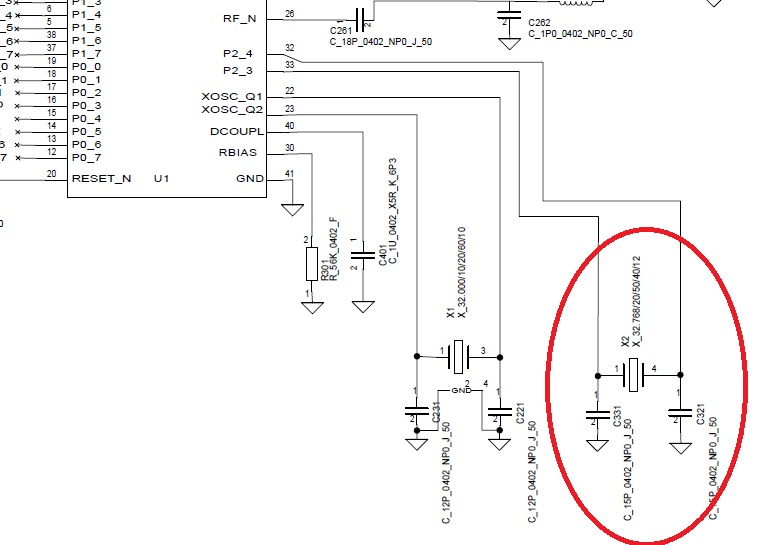

  • Hey Chatto, Thanks for the reply.
    Can you explain what the second oscillator on the TI Keyfob is doing? The USB Dongle omits this oscillator, and I'm wondering if this is truly necessary.  My board lacks this component, so perhaps this is what's causing the problems.
  • The 32kHz oscillator is required if one is to use power modes. i.e. for power management, when the device is in sleep mode it runs the ultra low power 32kHz oscillator, rather than the 32MHz oscillator that is functioning during active mode.
    The reason the CC2540 USB dongle does not have a sleep crystal is because, it is constantly in active mode when connected to a USB port.
    There is an internal 32kHz RC oscillator. However, the accuracy of this oscillator is not sufficient for BLE timing requirement and hence can't be used when using the device for BLE mode, where the device is in sleep for large durations of time, almost 90% of the time or more. Hence it requires an accurate clock which the 32kHz crystal oscillator can provide

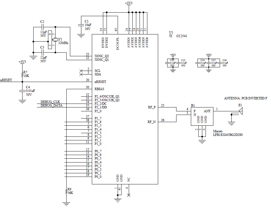

    My full schematic for the CC2540 component is below. Other than a few caps being different, I can't see any difference between it and the keyfob

  • Hi Jonathan,
    Why have you put a 10uF cap on the dcoupl pin? This is the output of the internal LDO and using another value than the recommended 1uF can make the LDO unstable which will lead to horrible things (like no RF).
    Apart from that I would highly recommend to follow the decoupling scheme from the reference designs, both due to stability, but also RF performance like spurious emission (it is unlikely that lack of decoupling is the root cause of your problem).
    I assume you have connected the ground pad (EGP) of the chip to the ground layer with several vias?
    /Fredrik

  • Fredrik, actually the ground pad is not grounded. Is it grounded internally? the next rev will definitely have it grounded. I'm going to change out the 10uF cap to 1uF, but unfortunately I wont be able to ground the center pad.
  • Hi Jonathan,
    That would definately explain why it does not work. I thought maybe the vias were not visible in the layout since you have a pin 41 connected to ground in the schematic. On a board with similar problem i drilled a 4mm hole through the PCB in the ground pad and strapped the EGP of the chip to surrounding ground plane on the bottom layer.
    The EGP is not connected to any other pins internally (which pins would that be?).
    /Fredrik
  • Hey Guys,
    So it's been a couple of days and I finally gave up on the board.  I started replacing component after component and nothing was working.
    I assembled a new board by hand, hand soldering the bare minimums (chip, balun antenna, bypass caps, decouple cap, rbias, debug header, etc).  I was mistaken in my post above when I said there were no center vias.  (I didn't design or assemble the first board).
    I made sure to solder the center pad via the back side and enough flux to make it flow.  In the end, the chip booted, programmed and advertised perfectly. I could connect to it, adjust color led, etc.
    In the end, I really don't know what was wrong with the initial board. It could have been that the center pad was not connected by the guy who assembled the board, or a pad disconnect somewhere.
    Regardless, thank you all for your support.  I'm sure I'll have more questions as I dig deeper into the ble stack.
