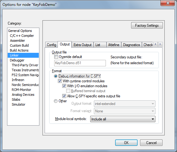

    Hi Jonathan,
          The first problem could be an issue with the debugger driver (which is written by the debugger manufacturer and not by IAR).  The second problem usually happens when the source code you have open doesn't match the debug information in the executable...usually a Rebuild All fixes this.  The third one again sounds like a debugger driver issue.  The fourth one can be fixed by clicking Project-Options-GeneralOptions-LibraryConfig and checking the box for buffered terminal output.  If you continue to have problems with your debugger after updating your driver and rebuilding your code, please send your code and the problem to support@iar.com so we can take a closer look at it.  Good luck!

  • Hey Shawn, so i wasn't able to find the checkbox you were talking about for buffering outputs in Project>Options>General Options> Library Config, but i was able to find it under the Linker section.
    Unfortunately, the checkbox is grayed out.  Any other ideas?
