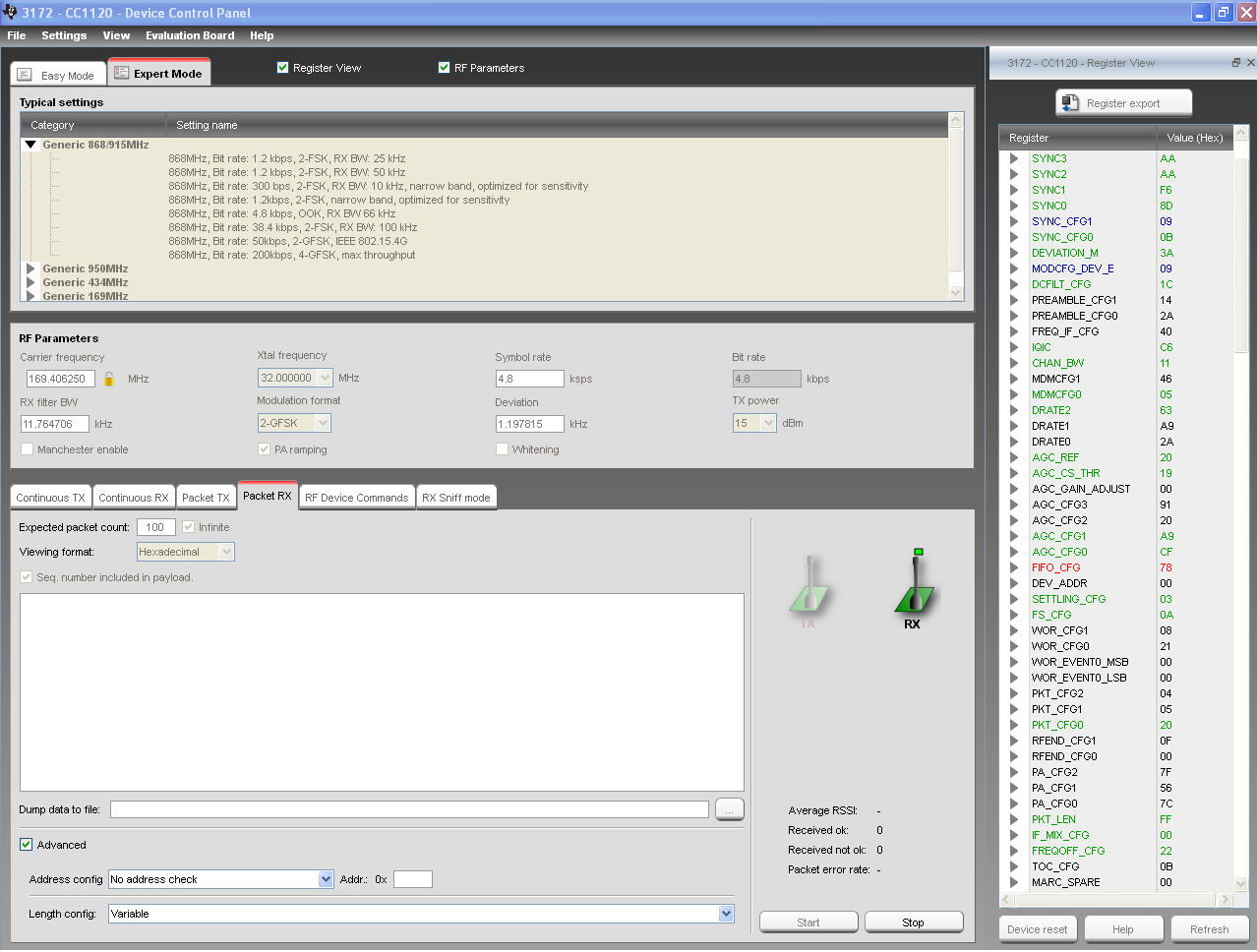

  • Hi TER,
    I tried with teh settings you gave me and doesn´t work.

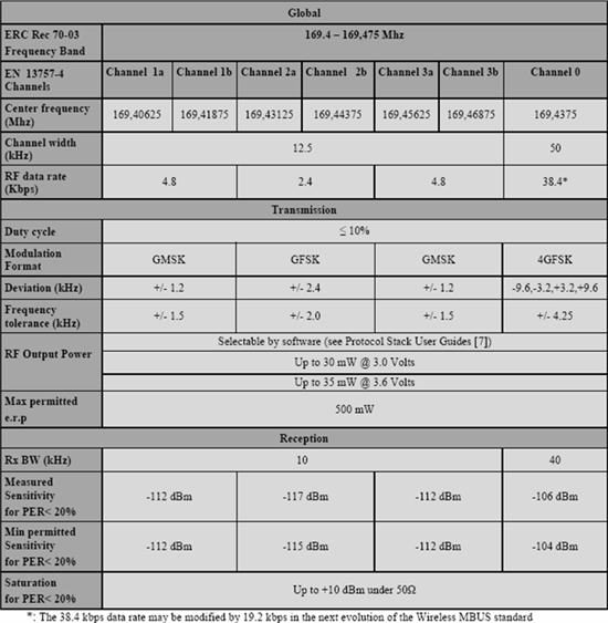

    For the test I use the SmartRF Studio with the cc112xEM module and an eval board from Telit for communications in wM-Bus. The Telit eval board I configure for channel 1a as the table below and I send typical messages:
    Channel Carrier Frequency (MHZ) Modulation Bit-Rate (kbps) Channel Bandwidth (kHz) Deviation (kHz) Max Power Output (mW)
    1a 169,40625 GMSK 4,8 12,5 1,2 500
    The registers I put as the ones for N1a mode from your spread sheet, and I put this frequency register values:
    FS_CFG = 0x0A
    FREQ2 = 0x69
    FREQ1 = 0xE1
    FREQ0 = 0x00
    Attached it is a capture for the smartRF Studio, using the Packet RX utility.
    The result it does not work. I also tried to change parameters for the paket length and CRC, and also doesn´t work.
    Any Idea to solve this? Am I doing something wrong?

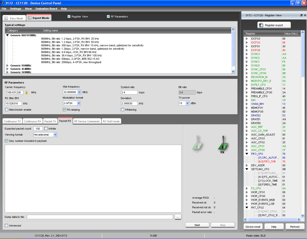

  • You have used N1c mode in the SmartRF Studio but the Telit unit uses the old N1a. Please note that the deviation is changed to 2.4kHz in this mode. What you have to do is to use the N1a settings I provided and change the deviation to 1.2kHz. The datarate and deviation have to be the same on both sender and receiver.

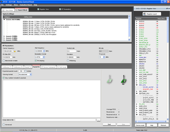

  • Hi TER and thanks again. I tried with the register values you provided me for N1a, and changed the deviation to 1.2 kHz (MODCFG_DEV_E = 0x09) as you told me. It continues without working. There are other registers that i have to configure. The ones I have changed are:
    PKT_CFG0= 0x20 --> Give variable length, the first byte after the sync word it is the length
    PKT_LEN= 0xFF  --> Max value of the packet length
    FS_CFG=0x1A; FREQ2= 0x69; FREQ1=0xE4;FREQ0=0xFF --> Frequency of 169.40625 MHz
    Here iti is a capture of the SmartRF Studio and also I attached a document

    What is it wrong? Maybe the modulation, because the Telit module uses GMSK and in the SmartRF Studio it is 2-GFSK.
    Any other idea?
    Many Thanks.
  • In this case a fairly narrow RX bandwidth is used. It is likely that you have a frequency offset in your system that cause the signal to be (partially) outside the RX filter.
    Try to increase the RX bandwidth to above 25kHz. Also measure the frequency on both the sender and receiver and compensate for the difference in Studio.

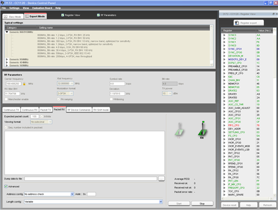

  • Hi TER,
    I have increase the Rx Bandwidth to 25 kHz first, and the to 33 kHz (Max Allowed). There is not result.
    I have measured in an spectrum analyzer the output signal of the channel 1a of the telit module and the frequency center peak is always betwen the 169.4053-169.4078 MHz, with a signal of -33 dBm in the antenna connector, so I think it is OK. The bandwidth of the signal measured at -3 dB it is of 15 KHz (from 169.400100 MHz to 169.41600 MHz) and the bandwidth of the signal measured at -80 dBm (50 dBm difference) it is from 169.35600 MHz to 169.46100 MHZ.
    As I tell you before, the modulation is different in the cc1120 it is 2-GFSK and in the Telit it is GMSK. I put here a capture for the Functional characteristic of the Telit module.
    Any idea more? Thanks for your help.
