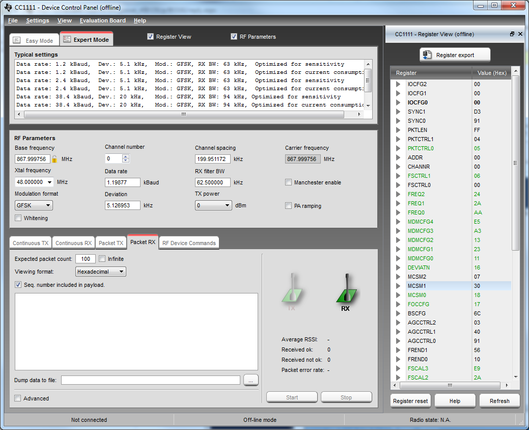

Smart RF Studio has no Sniffer export like the documentation shows, and still no sniffing...
Other Parts Discussed in Thread: STRIKE, SIMPLICITI, CC430F5137, TEST2
I have the latest 1.10.0 version. Not a big deal because I can program the RF settings manually, but several parameters are missing and it doesn't pick up any packets except for the occasional random (unfiltered) noise. I think I've ruled out transmission problems (used two TI boards and our boards through Smart RF Studio, both stock and manual RF settings) and nothing + the Spectrum shows activity.
Any clues?

  • I flash loaded the C1111DK_Dongle with the sniffer program using the CC Debugger. Register settings are per below. This should work??? Led is green on the C1111 when plugged in, and it shows in the sniffer.
    The other point was to use Smart RF studio to export the setting off my hardware in the Sniffer prs format, but that option doesn't exist in the RF Studio menus, V1.10.0

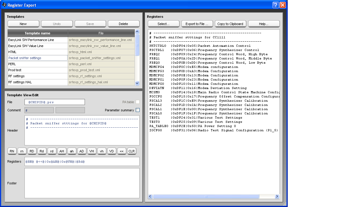

  • Hi John,
    Regarding your second point about missing option to export prs file It would be interesting to know where you are looking for this option?
    If everything is OK with your installation you should find this option in the "Register export" dialog. Below you see a screenshot of the Register export. Under Template name there should be an option called "Packet snffer settings". The template is a file that is installed together with the rest of SmartRF Studio. Let me know if you don't see this option in the Register export dialog.
    Øyvind
  • Packet Sniffer option is missing, so missing or wrong template? Thanks.
  • It seems as if something went wrong during the installation. Normally you should have the following template file installed: srfexp_packet_sniffer_settings.xml
    On my installation (XP machine), I find it on the following location: C:\Program Files\Texas Instruments\SmartRF Tools\SmartRF Studio 7\config\codeexport
    If you try to export something the complete set of templates are copied to the user folder. On my XP machine this is:
    C:\Documents and Settings\<user id>\My Documents\Texas Instruments\SmartRF Studio v7\codeexport
    Reinstalling SmartRF Studio might help or if you like, I have attached the template file.
    To be sure I cleaned up my PC and reinstalled SmartRF Studio. The template was installed. Let me know if you still have problems with the template.

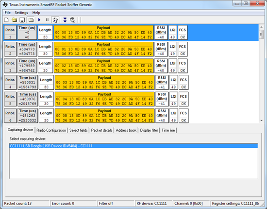

    It seems to me that there is some problems with the settings and to make sure it will work sniffing packets from CC430 with the CC1111 I tried it myself.
    I installed latest version of SmartRF Studio from the web (1.10.3). Started an off-line session for the CC1111 to export registers. Selected the right RF settings according what is used from the transmitter. The screen shot below show the device control panel:
    Make sure to select "Packet RX" because the sniffer will operate as a receiver. In my case I used the settings for 1.2 kBaud. I had to adjust the Base frequency because this was not the same as I was sending from CC430.
    Then select "Register Export". Screen shot below show the options I get:
    Then "Export to file" to make it available to the Packet Sniffer. It will also ask if you want to start the packet sniffer with these settings. I chose not to since I had already started the packet sniffer.
    In the packet sniffer I selected "Radio configuration" and "Browse" to load the settings.

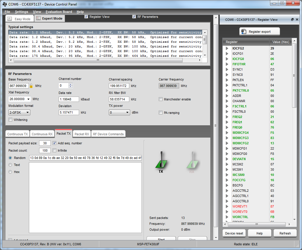

    For the sender I used SmartRF Studio and CC430F5137RF900 board. Below is a screen shot of the Device Control Panel.
    As you can see from the screen shot of the packet sniffer I was able to sniff packets.
    First of all I hope you are able to export settings from SmartRF Studio. Make sure to export settings for CC1111 and that the RF settings matches the settings used for CC430.
    Hope this help you to see some packets.

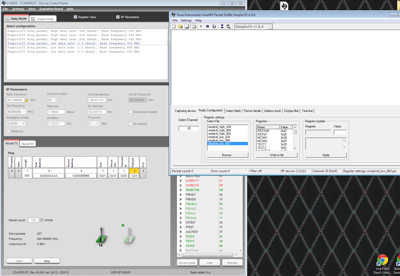

  • Here's my screenshot showing I'm using the SimpliciTi 902 low settings on both ends, and nothing. Tried all 4 SimpliciTi protocols.
    Any ideas? Thanks 21
  • I don't have any HW at hand to try this now so I can't say why this is not working.
    One possibility to check the sanity of the CC1111 Dongle is to use it as a receiver in SmartRF Studio. In fact that's the easiest way to find settings on CC430 and CC1111 that gives you a connection between the two. If you connect the CC Debugger to the CC1111 Dongle the same way as for programming the FW it should show up in the list of connected devices in SmartRF Studio.
    Indeed the CC430 and the CC1111 have the same radio but they are probably running with different crystal frequencies. This might give a slightly different base frequency. In my case it was not enough to not get a link though. Also remember the other RF parameters like modulation and stuff but this is a bit out of my league. I'm only working with SW for our tools. You probably know the RF parameters better than me. If I'm not totally wrong I think it could help to increase the RX Filter bandwith on the receiver to see if you are able to receive anything.
    When exporting the register settings only the values different from the reset value is taken into account. That is normally all the none black colored registers.
    Øyvind

    Thanks!
