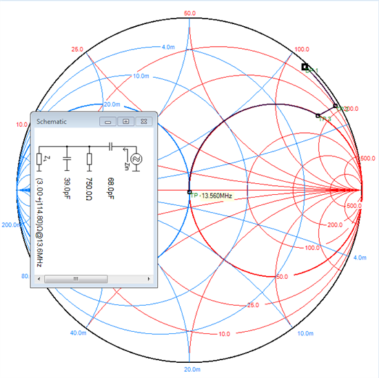

I've got a TRF7970A EVK board connected to a coil through the SMA connector, and I am using the RSSI level in Reg0x0F to evaluate coil read range. I've placed an RFID tag in the centre of the coil and I am monitoring the RSSI level.
When running at Full power, my Main and Aux RX strength are 5 and 0 respectively.  Using Half power, my Main and Aux RX strength are both 5.
This seems counter-intuitive, so what else is going on?
I guess that if my coil is does not have a characteristic impedance of 50ohms, then the 4-50ohm impedance matching circuit will behave differently - giving an overall better power transfer when the output impedance is 8ohms? What do you guys think?

    You did remove R3, corrrect (to disconnnect the onboard antenna ckt?) if not that could be one area to take care of and then also, when you say your coil - you do mean your tuned coil, correct? (meaning you are providing your own series and shunt elements, with a Q factor appropriate for the tag technology you are using)
  • Josh,
    R3 has been removed.
    I measured the coil in isolation to have an impedance of 3+114.8j. Used a shunt resistor of 750R, shunt cap of 69pf, and series cap of 39pf. Then I connected the coil through a Skyworks switch, so I can connect multiple coils. I should have a Q of 6.5 and a bandwidth of 2.08MHz.
    I've measured the tuned coil through the switch to have a characteristic impedance of around 44ohms. I've got a transmission line that goes through the switch and then can get terminated with my calibration load - that gives |z| of 54R.

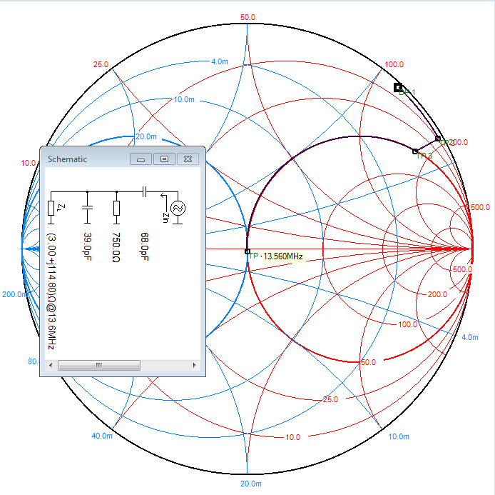

  • I agree that you R should be around 750 ohms here for that Q factor, however, i plotted out your tuning solution on the Smith Chart and i think you should adjust it the other way round.
    your shunt cap (in parallel with the R and the coil) should be 39pF and the series element should be 68pF. pls.check that out.
  • Josh,
    Sorry about that, I meant I had series cap of 69pF and a shunt cap of 39pF like you've shown.
  • Right - so the best to do - if you have a power meter or spectrum analyzer - is to hook it up (using attenuators if needed by the instrument so you don't damage it) and measure like what i have shown in this document (using the Peregrine digital switches) and see if you can get some more data about what is going on with your ckt.
