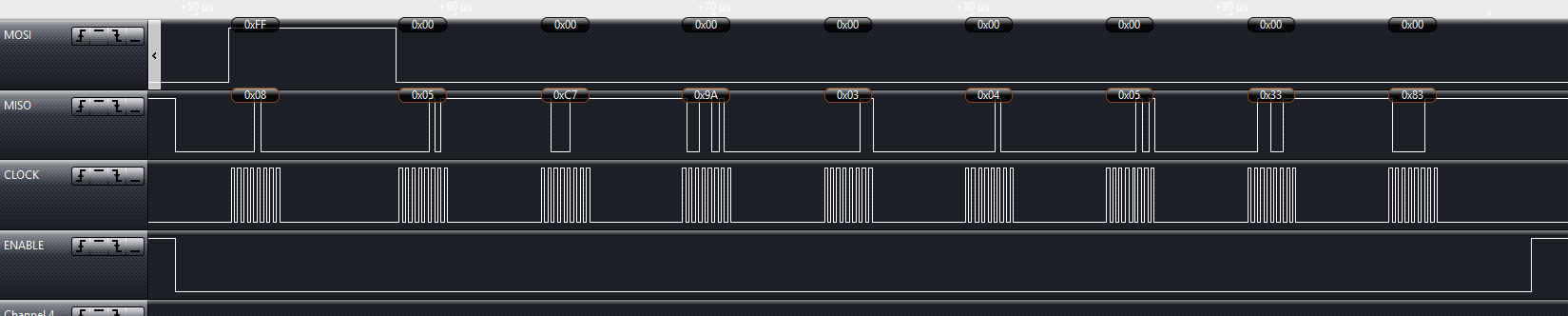

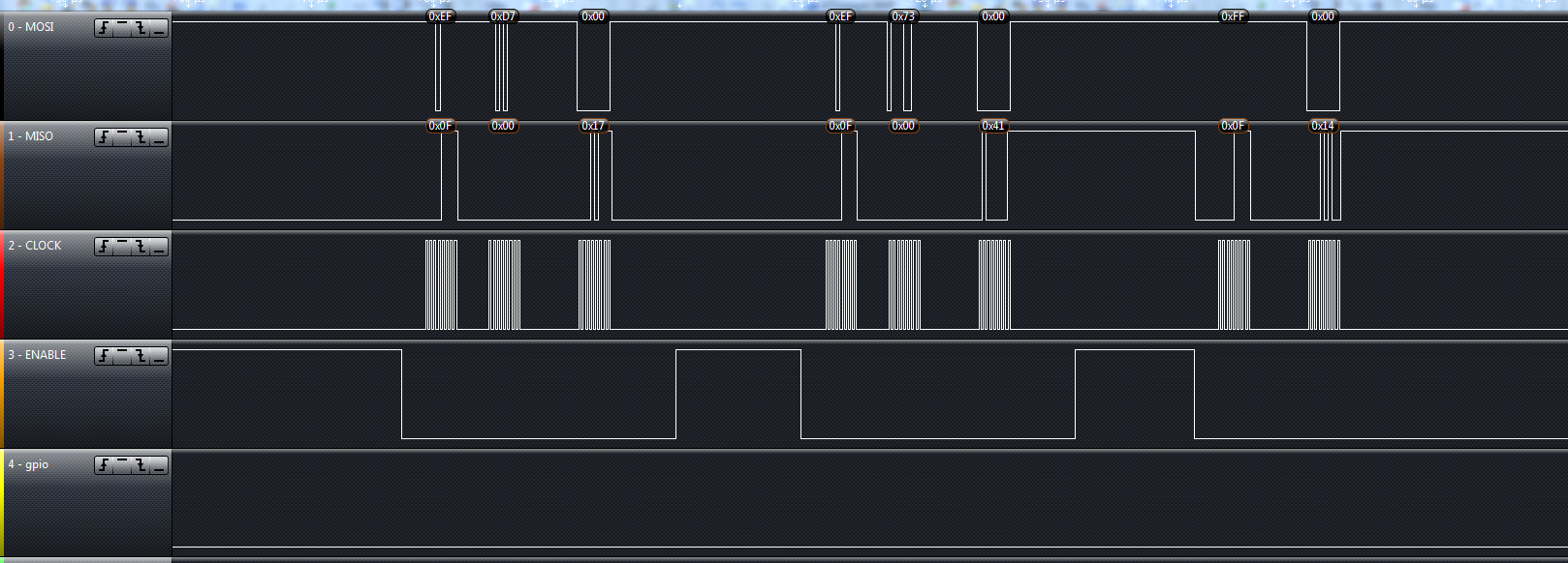

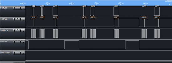

I'm trying to connect my own MCU to the CC1125 via its evaluation board. I believe that I have everything wired together properly. What I need help with is some of the SPI stuff. I ran the cc112x_easy_link software with the evaluation boards MPS430 mcu and I used a logic analyzer on the SPI bus, then I wrote the software for my MCU and ran it on the SPI bus and compared the two. My timing diagram is nearly identical, however I'm getting different status values back from the CC1125. I'm seeing that the mps430 gets back a status byte of 0x7F for each write command. Mine however is getting decremented values that stay between 0x7F and 0x70, cycling over and over again. (I've attached images for reference).
What status values should I be getting? 0x7F?
  • Hi Jason
    The returned status byte you are getting indicates a TXFIFO error condition. Have you done any TX operations before this plot? When debugging SPI communication I would recommend being in a known state (IDLE).  After a fresh reset of the chip and being in IDLE state the returned status byte should be 0x0F when you write to the radio and 0x00 when you read from the radio.
  • I just did another logic capture and I think I have more specific information to share. I start off by initializing all of my registers. For the first two registers that I transmit to, I get back a status bytes of 0xFF, these are returned at the same time, so should each refer to the previous transmission to line them up? The remaining registers all transmit properly returning a status byte of 0x0F for each one. Once I get into the extended registers, each of the three bytes receives a status byte pattern of 0x0F 0x00 0x0F.
    Then I begin a FIFO burst access of 30 bytes. Each byte receives a status byte returned of 0x0F. CSn is brought back high, then I drop it low again and command strobe 0x35 to flush the FIFO. When I send the flush command, the byte that is returned at the exact same time is 0x0F (again, is that for the command at the same time or the previous command?). Then when I go to begin another 30 byte transmission, every single status byte that I receive is 0x5F for the second packet. Then when it goes to send another 30 packets, the received status bytes are all 0x2F. Then the status bytes start decrementing and are all different.
    Any idea where the error is happening and how to debug it?
    Thanks!

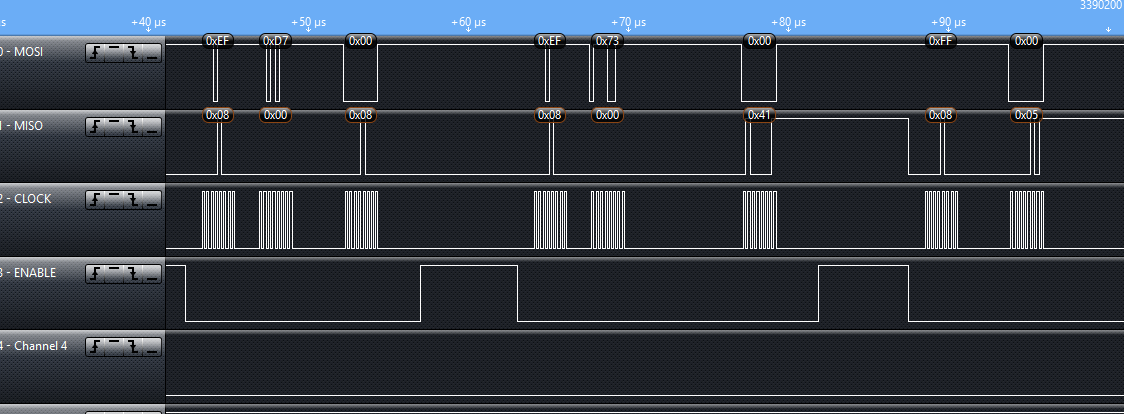

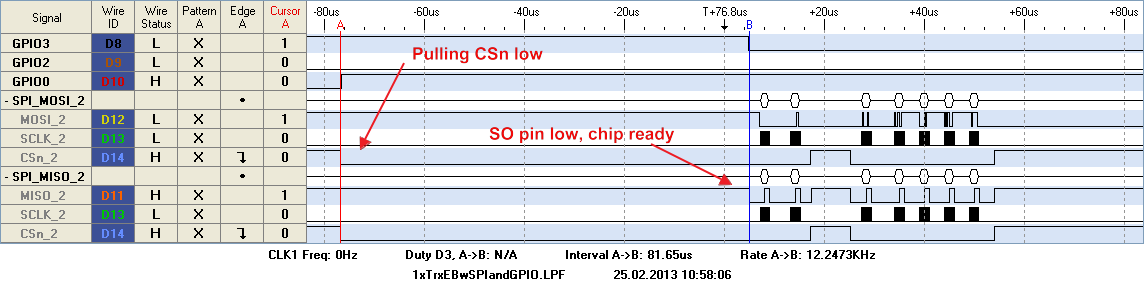

  • Hi Jason
    First of all, the status bytes indicates the actual state the radio is in when the CSn line is pulled low and does not relate to the previous command ( except when altering radio states). If you issue multiple command strobes the status byte will not change until the actual radio state has changed (see the data sheet for transition times).
    When you get a status byte of 0xFF, this tells me that the radio is not ready (CHIP_RDYn bit is high) when you write to the chip. When you wake the chip up from powerdown or just turned the chip on, the crystal needs time to start up and stabilize. When the crystal is stable the chip is ready for operation and you can start to write or read to it.This is indicated by the CHIP_READYn bit or the SO line which when you pull CSn low the SO line will stay high until the chip is ready. If you try to read or write to the chip before it is ready you can get unknown results. A proper write sequence after wake up from power down can be seen in the following plot:
    This will be normal behaviour. If you fill the TXFIFO with 30 bytes and strobe 0x35 (BTW this is a STX strobe not a TXFIFO flush which is 0x3B) you will get a status byte indicating IDLE state (0x0F). When you then start to fill the TXFIFO with more data, the radio will return a status byte of 0x5F indication SETTLING state. The radio is now going from IDLE to TX as stated by the STX strobe you sent. For the next 30 bytes you write the radio has come into TX state and indicates this by a status byte of 0x2F.
    The F part indicates how many bytes you have free in your TXFIFO (this is undocumented), F indicating 15 or more bytes free.When you continue to fill the TXFIFO this number will decrease as you approach the TXFIFO limit of 128 bytes.
    So in this part there is no error in the status byte as I can see.
  • Martin,
    Thank you, that timing diagram was very helpful. I've added a while statement that waits for MISO to drop low and the results have made me confident that the first few registers that are being sent are being received.

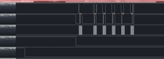

  • About how long should it take for the data to be transmitted? I'm clocking about 40 ms before the GPIO2 line interrupts.
    My MCU seems to stop doing SPI while it's waiting; once the GPIO2 pin comes back up, then my SPI will transmit maybe a couple bytes and then just cut off. never to transmit again.
    I tried polling MARCSTATE but I'm not sure if I'm reading data correctly.
    The GPIO2 pin goes high after about 40 ms, then stays high for 300 ms; is this accurate?

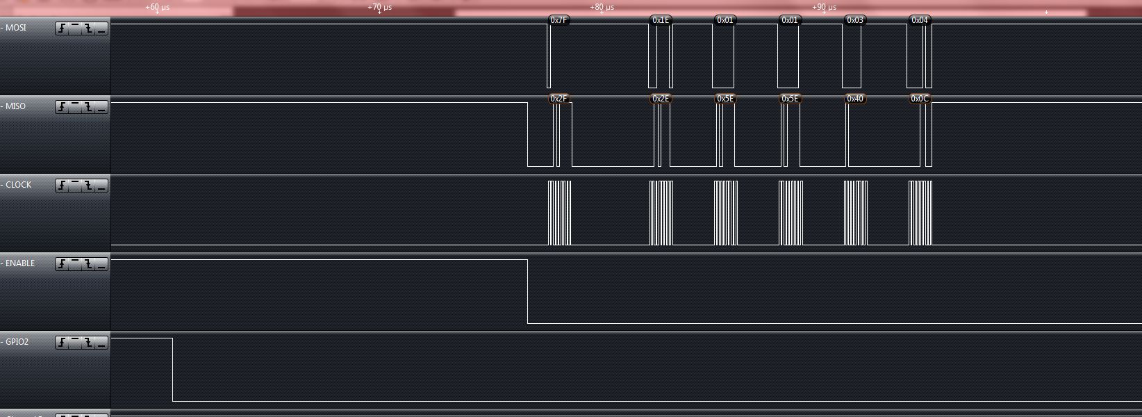

  • When the transceiver is "settling" does that mean it is transmitting? For instance, if I am getting a status byte of "settling", when that returns to "TX mode", does that it is done transmitting?
    If the GPIO2 pin is set up for PKT_SYNC_RXTX (0x06), then it should go HIGH when? When the packet has been transmitted? Or when the FIFO is empty? When does it go back low again? Should I only check this pin when sending packets, and not for any register access?

  • Hi Jason
    When the tranceiver is in settling state the PLL is settling. This happens between the IDLE and TX state and the radio will not transmit anything before it is in TX.
    The PKT_SYNC_RXTX goes high when the SYNC WORD has been sent and de-asserts when the last byte of the packet is transmitted. The timing of this signal will therefore be dependent of the length of the packet, sync word and the data rate. For more detail on GPIO signals please see section 3.4 of the user's guide
    As long as the radio is in TX there is no need to send any STX commands. The STX strobe is used to set the transceiver in TX and will be ignored if the radio is already in that state. If you are already in TX it is enough to fill the TXFIFO with the next packet for it to be transmitted

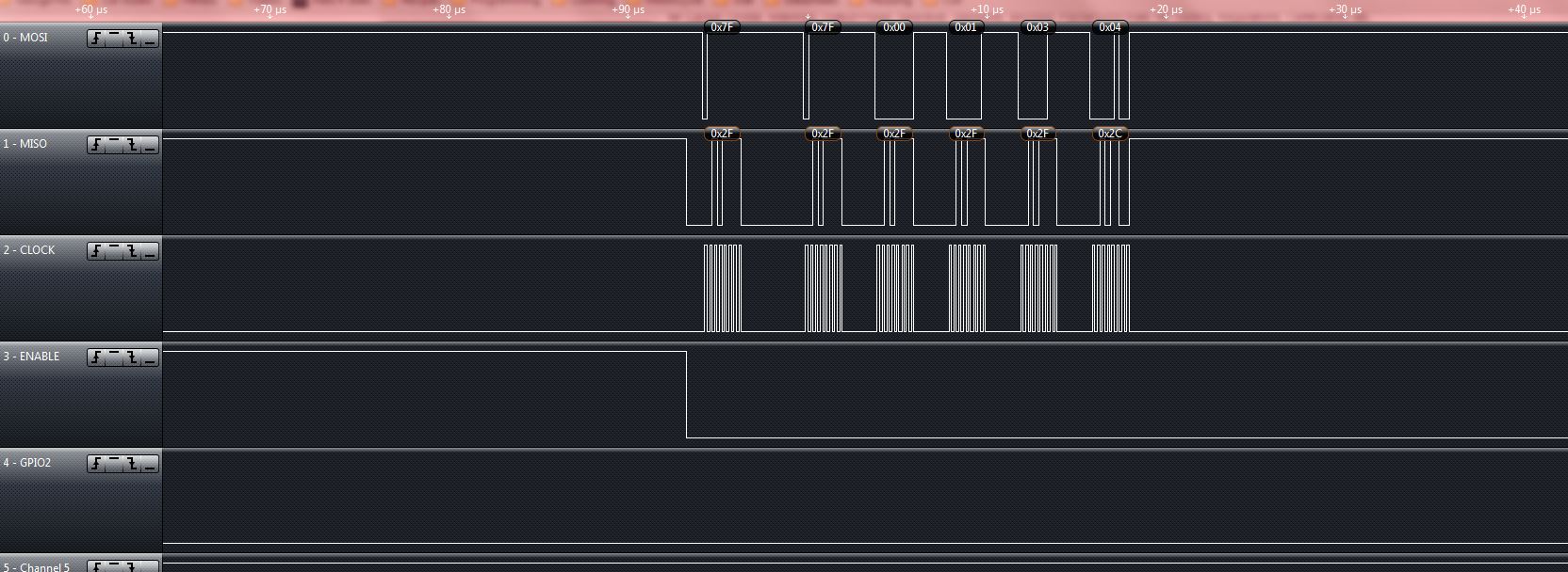

  • Ok that is all very helpful.
    Just to make sure that I'm on the right page...according to "Table 2: Status Byte Summary" on of the manual, the upper 4 bits tell me the status of the chip, and I can disregard the lower 4 bits? Or do those lower 4 bits always indicate the amount of space left in the FIFO buffer?
    Once I've sent a packet, I wait until PKT_SYNC_RXTX goes high, and then I continue waiting until it goes low. Once that happens, I begin sending another packet. I've attached a logic capture showing what happens when I do that however. I'm not sure if it is my MCU or not, but I'm noticing that after a couple bytes, the status changes from Tx, to settling, to calibrate, and then to idle, and then SPI comm completely stops with nothing at all happening after that (it doesn't finish the 30 bytes, and then never transmits again). Is the transceiver holding all of my SPI pins high?
    I believe that I'm getting stuck in a while loop that waits for the MISO line to drop low...but it is staying high constantly. So I don't think it is my MCU.
  • You can disregard the lower bytes as they are not guarantied to give you a correct value. From the plot you posted there is something wrong with the transmission but it is hard to tell what can be the cause of this without more information. Could you please post your register settings and a code snippet of your application? This would be of great help to debug this further.

    The problem that I'm having now though is getting the rx to work. My logic captures are byte for byte the same just up until the SPI stops working.
    This is a logic capture of my device. After a few bytes from the rx fifo, MISO stops going low.
    This is a capture of the eval board doing the same thing, but functioning properly
  • Hi
    It looks like you do not have the entire RXFIFO read in your first plot. It is not possible to see anything wrong with this read, but it is only the first byte that shows in the plot.
    Based on the two plots the RXFIFO read looks excatly the same, at least the part that is visible in the plot.
  • What would cause the rxfifo to stop sending data over SPI? In some other runs, the rxfifo sends everything but the last byte, and then hangs forever.
  • Do you always miss the last byte, regardless of packet length? I cant think of any reason for the RXFIFO read to hang when you are in IDLE. If you try to read more bytes than available you will always get zeros after the last byte had been read.
    You can try to read from the RXFIFO with direct fifo access and see if you are able to read out the entire packet.
  • It looks as if it is intermittent. For instance sometimes I'm only getting the first two bytes before MISO goes high and stays high, and then other times, I'm able to get all of the data out of the buffer.
    More often than not though it looks like this...
  • What do the first two bytes in the buffer indicate? Once it starts pulling data out of the buffer the Trxeb board gets 0x08, then 0x05, then the two bytes containing the packet number, then the data, then 0x33, and finally some byte that starts 0x8_.
    Mine goes 0x0F and then 0x14 followed by either nothing at all, or everything through 0x33, except for the final 0x8_ byte.
  • I figured it all out. My function that waited for MISO to settle wasn't just doing it after the CSn went low, but for every byte to be sent. Fixed it, and everything is resolved.
