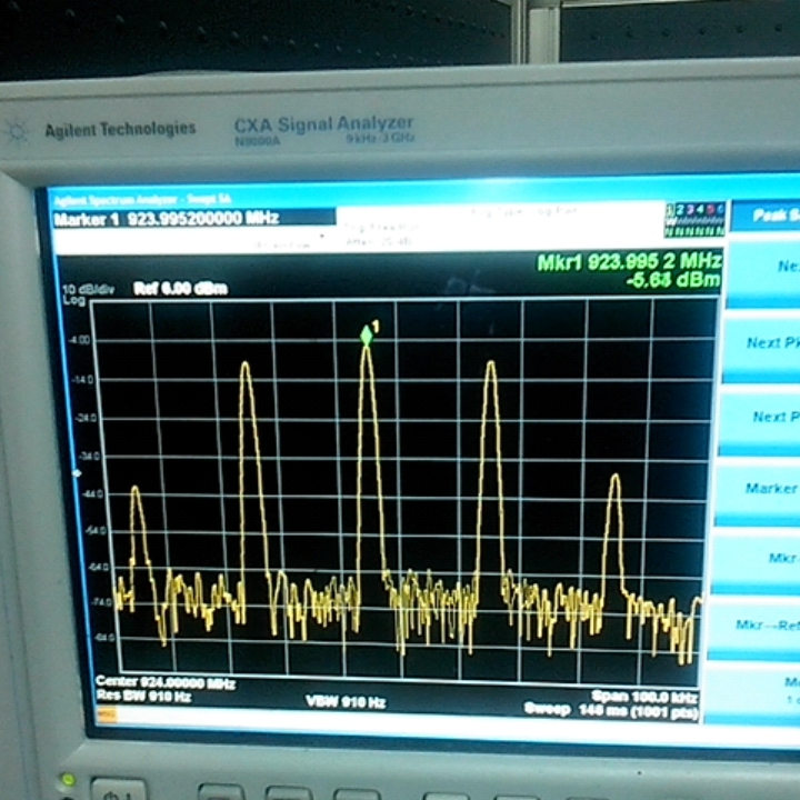

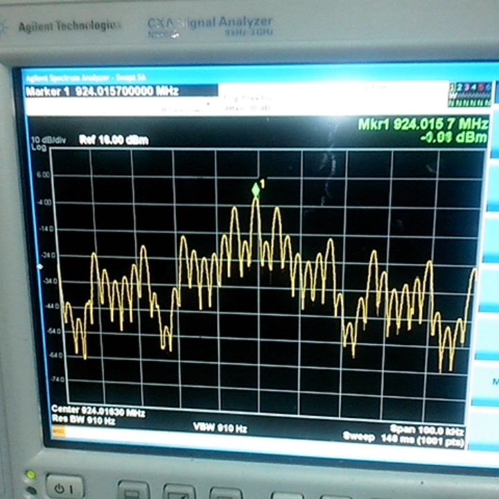

   When I use the CC1120 Transparent Serial Mode,I set  the CC1120 GPIO0  pin  is  explicitly  used  as  serial  data  input,and use the MCU to output a 40KHz digital signal to connect CC1120 GPIO0 ,but the Spectrum is so many harmonic wavelength,just like this picture:
Compare with this one from using the  TrxEB PCB (MSP430 uP) and CC112xEM from SmartRF Studio 7 procreant which we wnat.
And this are the register settings:

Any suggests to me to solve the problem?
PS:
    When I use the  TrxEB PCB (MSP430 uP) and CC112xEM from SmartRF Studio 7,I didn't probe any digital signals
into the the CC1120 GPIO0  from MSP430 uP using the oscope.How does it produce the Spectrum.
 Best regards
Mickey Li
  • When you have low RBW you will observe the the line spectrum. When you transmit a 0-1 sequence you will see spikes at a distance given by the modulating frequency.
    To transmit random data set PKT_CFG2.PKT_FORMAT = 2. This option is included in SmartRF Studio: Continuous Tx -> Tick off "modulated" -> select data format "random mode".  Alternatively, use transparent mode and apply random data at the GPIO and not a 0-1 sequence as is the case if you use a square wave with fixed frequency as input source.
  • Thanks Sverre,
                  When I use the  TrxEB PCB (MSP430 uP) and CC112xEM from SmartRF Studio 7 on CC1120 Transparent Serial Mode,I haven't probe any square wave put into  the CC1120 GPIO0  from MSP430 uP using the oscope.But in the spectrum I can see the modulated data,just like the follow picture .How does it work ?or how can configs registers?
     Thanks a lot!

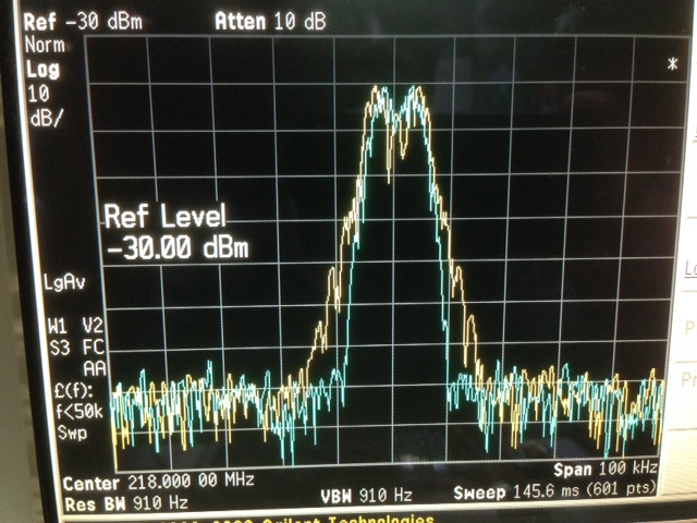

  • You can use CS to achieve a mute function.
    If you increase the programmed data rate the spectrum mask will not be affected. The data input in TX still has the same data rate and this (+ frequency deviation) is what defines the occupied bandwidth. If you increase the programmed data rate in asynchronous serial mode you simply increase the oversampling of the data input and this can potentially reduce the TX jitter.
  • Not sure if I am doing this correct Sverre to increase the programmed data rate.
    I loaded your file for transparent Rx serial mode and selected continous TX with transparent serial mode.
    With the original settings of 4KHz dev, 2.4kbps, 15KHz BW  I get the Tx mask in blue, nice and clean. The file I used from you is:

    To increase data rate from SmartRF7 I changed symbol rate to 7ksps as the bit rate cannot be changed this gave me 7kbps bit rate.
    The Tx mask got wider as shown in the yellow plot
    The Jitter did reduce going from 2.4 to 7 ksps but the Tx mask gets worse.
    What am I doing wrong?
    Ps the frequency has been converted down to 218MHz from the original 868 MHz!!
