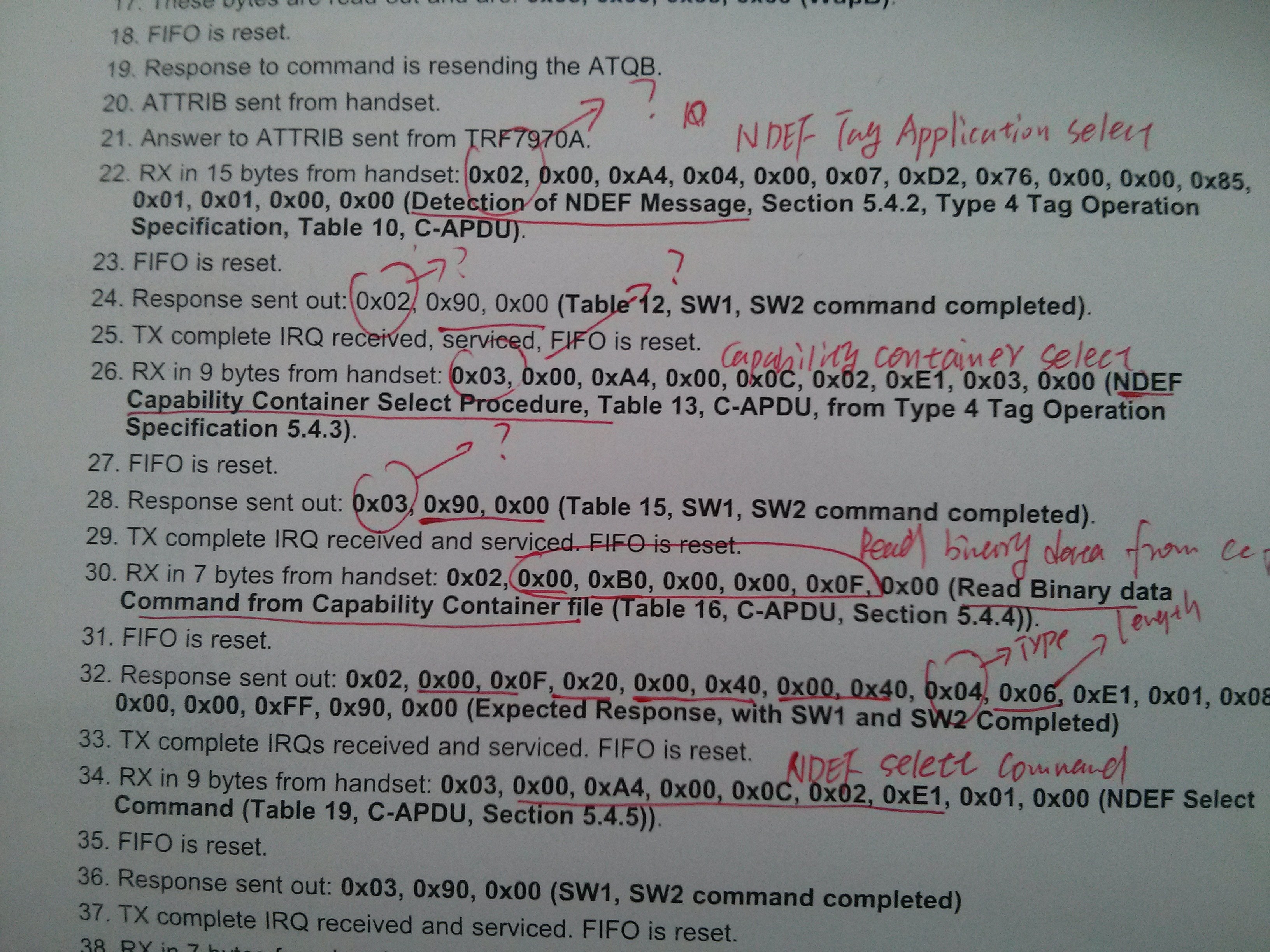

I am a new guy on RFID\NFC,and   I'm pluzzed by Ti's describtion when i look over  page22 on SLAA512.
I don't know why a prefixed byte "0x02" or "0x03" turns up her. so  I  look over <NFCForum-TS-Type-4-Tag_2.0>  .
and I found there 's no demand of a prefixed byte '0x02' 0r '0x03'  during the NDEF detection procedure.
so ,  I have 2 questions need some one to help .
1st)  Why TI  add the prefixed byte '0x02'/ '0x03'  on here?
2nd) If TI add this prefixed byte ,it sound like incompatible with  <NFCForum-TS-Type-4-Tag_2.0> . Can some one explain this?
Thanks.
  • These bytes you are asking about are called the Protocol Control Bytes (PCB) bytes and are from ISO14443-4 standard. The NFC Forum neglected to add those into any of their documents, but they are required to indicate if the data transmission is an I-Block, an R-Block or an S-Block.
