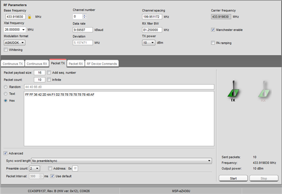

We are currently using Atmel transceiver ATA5428 on 433.92MHz but are looking to replace this with a more modern transceiver. We want the new transceiver to be able to communicate with ATA5428, i.e. backwards compatible.
I have started to test if this is possible using an eZ430-Chronos-433 kit and Smart RF Studio 7. I enter our current configuration in Smart RF Studio:
433.92MHz
On/Off keying, Manchester coding
9600 baud
Preamble: 0xFF 0xFF
Unfortunatly I can not manage to get the TI and Atmel transceivers to hear each other. I can see the received power in "Continous RX" mode but no packets arrive in "Packet RX". So my question is; is it possible to get an Atmel and a Texas transceiver to talk using On/Off keying?

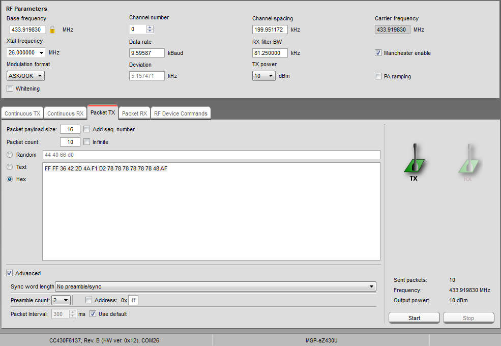

    I have turned off both preamble and sync, however when sending data from SmartRF Studio I emulate the expected preamble (0xFF 0xFF) and sync-word (0x36). An example package looks like this: FF FF 36 42 2D 4A F1 D2 78 78 78 78 78 78 48 AF
