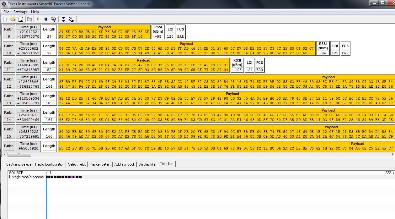

  • I have read SmartRF packet sniffer manual.I did the configuration according to manual.But in my case SmartRF mudole sniff some garbage data,but i have turned of wireless devices. I want to know about that data,from where it comes???. Secondly, there is always FCS error. However, I am using Generice protocol. Following is the my sniffing result

    I have changed base Frequency 434 Mhz in Smart RF studio 7 save the register setting as .prs extension. Then open the Packet sniffer select the SimpliciTI  Protocol. but still did't get packets.
    By changing the Base Frequency 902 MHZ I can sniff packets with error but I don't know from where these packets comes because wireless Transciver Mudole is off.
    can we change SmartRFCC1110-868 base frequency  to 433MHZ??
    Kindly guide me what is the main problem.
