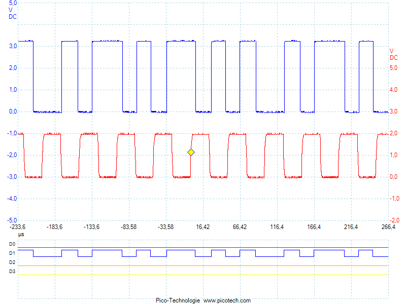

using today CC112x (434MHz) in transparent mode we made some tries with CC1200 DK to check jitter behaviour.
What we've seen so far is frightening: CC1200 behaves much worse than CC1125/1120, so my hope is that we do something wrong.
Test environment is 2 x TrxEB with several settings, input is a generator with tests between 500Hz and 4 kHz.
Starting with default 1,2 kbps setting, outpur/input looks like (red is input):
So we tried default setting '50kbps' and fed 10kHz input signal, it looks (similar) like this:
Even applying the old trick to oversample TX by applying 8k symbol rate for 3k input frequency does not give much improvement.
Specially when we we compare to our 1120, 1120 delivers a solid output when using the same parameters.
So what's happened in CC1200 development, it's as-is far away from data sheet ("up to several 100k in transparent mode").
Please advise

    I did a quick test yesterday where I used a SG to send a '01' sequence to a CC1200 EM. I tested up to 200kbps without seeing any problems except for the known jitter. Have you tried with a known good sender?

  • Addendum (ALWAYS REMEMBER THAT WE TALK TRANSPARENT SERIAL MODE):
    Tried a SG as sender. SRF RX default setting 434-first default line (1.2kbps, etc.). Set the SG accordingly.
    Result: only at exact 600Hz output is somehow OK, if I change to eg 580 oder 630Hz, it becomes dirty.
    Same if I use our own setting (found in weeks of tests with CC1125): 16kBW, 8k symbol rate, 5k dev: as long as I use an even divider like 1kHz/2kHz etc, output is OK. As soon as I leave these "even" frequencies, output becomes unusable -> this is not jitter and one-to-one tests to our 1125/1120 shows, that this is CC120 specific.

    Meanwhile I did a pure 1:1 test: Signal generator with antenna plus
    a. CC1125 EM plus antenna
    b. CC1200 EM plus antenna
    Test modi:
    1. Default SMartRF 434MHz, 1.2kbps, SG set accordingly. Then I tune SG modulation frequency: at 600Hz output both EM look the same. As soon as I tune slightly to e.g. 620Hz CC1200 output starts flickering (like shown in my initial message). CC1125 remains stable up to 800Hz.
    2. 'our' range setting: 16k BW, 5k dev, 8k symbol rate: as long as I stay at 1/2/4kHz modulation, both EM look OK. As soon as I leave by a few Hz to e.g. 2.1kHz, CC1200 output signal becomes unstable (see above)
    Meanwhile I know the CC good enough to conclude, that CC1200 sampling in transparent mode does have an issue (compared to CC1125): in transparent mode you can't predict the exact data rate, but the RF circuit need to deal with that.
    I still hope that this is not a design issue ...

  • I looked some at today and saw the same as you; programming a datarate equal to 1.2kHz on the chip and and using 1.24kbps on the generator it looks like the receiver skip every n bit. In transparent mode what you program the datarate to on the chip should not matter but we have to investigate further to find out why.

    You say it looks like it would skip bits - it's worse: look at the duty cycle of the output signal, there is no single phase like the original.
  • When I did test in the lab it looked like that I got the same result as you (It looks like v1.13.0 of Studio does not enable transparent mode I found out now)  but I got one of the software people to convert some code from CC1120 to CC1200 and with this code everything are working just fine.8078.cc120x_transparent_mode.zip
    We did 2 tests; with the 50bps settings and 1.2kbps. For the first one we sent with 11.3kbps and the second 647bps without seeing any problems.

    But: is this then a bug in Studio's parameter settings? You can't setup a communication with different symbol rates between two CC1200, this is for sure. So please try to setup Studio with something like that with uneven sender/receiver symbol rate ratio - this doesn't work.

  • It is very few registers that are set in the code:
      CC120X_IOCFG3=0x11
      CC120X_IOCFG2=0x09
      CC120X_MDMCFG1=0x06
      CC120X_MDMCFG0=0x65
      CC120X_AGC_CS_THR=0x16
      CC120X_PKT_CFG2=0x07
    Carrier sense is used in the software example but not required. Have you tried with these settings?
