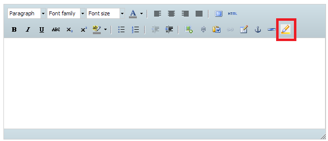

    Also, you can use the button highlighted below to insert your code and it will format it to make it a little more readable.

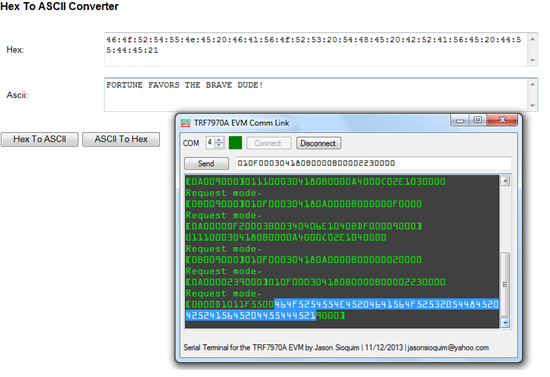

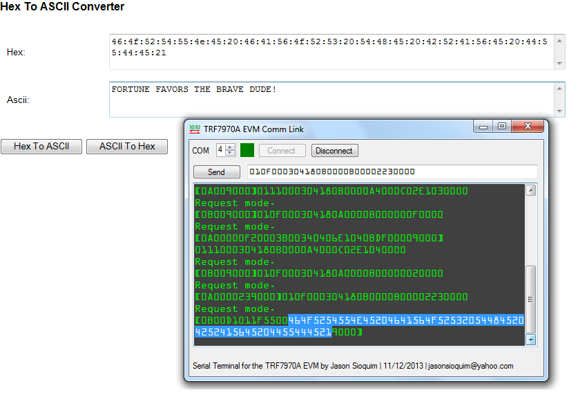

  • Hi Sven,
    I tried to read the data using the TRF7970A EVM and a serial terminal and it finally worked! Thanks for your help! I attached a snapshot of a serial terminal and the converted hex code with a test message.
    Cheers!
    Jason
